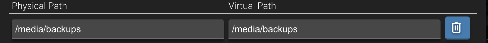

a. Click on the “pencil” icon on the instance from ADS.
b. Go to the Storage tab.
c. Add the following:
  • Physical Path (the path on the host): /media/backups
  • Virtual Path (the path in the container): /media/backups
d. Click + to save.
Note:
The above approach will make everything in /media/backups on the host available in the Docker/Podman container. That may include backups from other instances, if you configure the above for those other instances too. If you don’t want that, you should mount a unique location on the host to the location in the Docker/Podman container, like /media/backups/Minecraft01. Ensure that the location exists on the host and has the right ownership.

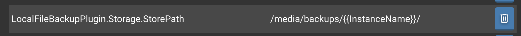

a. In ADS, navigate to Configuration->Instance Deployment->Deployment Defaults->Default Settings.
b. Add the following:
  • Node: LocalFileBackupPlugin.Storage.StorePath
  • Value: /media/backups/{{InstanceName}}/
c. Click + to save.
Note:
  • The variable {{InstanceName}} used above will place the backups in their own subfolder based on the instance name. A unique name is important for backup separation in the new location.
  • Ensure you have a trailing slash on the path value.

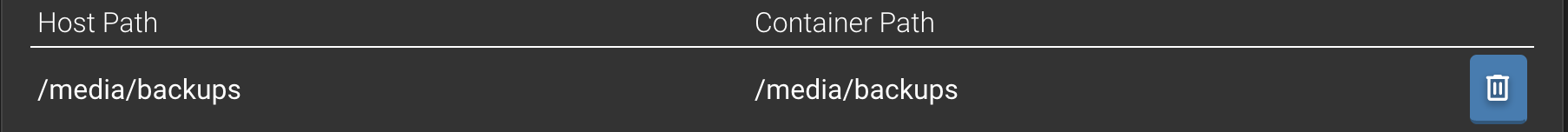

a. In ADS, navigate to Configuration->Instance Deployment->Deployment Defaults->Default Mount Bindings.
  • Host Path (the path on the host): /media/backups
  • Container Path (the path in the container): /media/backups
c. Click + to save.
Note:
The above approach will make everything in /media/backups on the host available in the each Docker/Podman container created with the above setting. That will include backups from other instances that are created with the above setting. If you don’t want that, don’t include the above, but configure a unique location on the host for individual instances after creation - see the Note in 2.2 above.

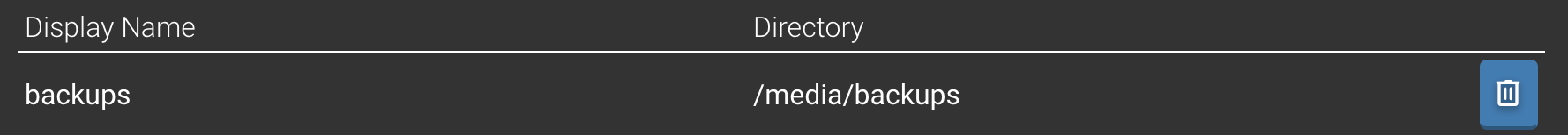

a. Go to Configuration->File Manager->Virtual Directories.
  • Display Name (the name of the virtual directory displayed in the file manager): backups
  • Directory (the path to the backup location): /media/backups
c. Click + to save.
d. Restart the instance.
Note:
For Docker/Podman instances, use the path as mounted in the container, not the host path, if these are different.

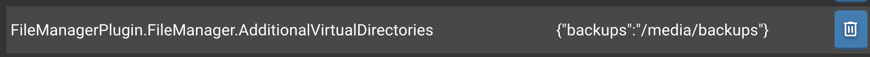

  • Node: FileManagerPlugin.FileManager.AdditionalVirtualDirectories
  • Value: {"backups":"/media/backups"}
c. Click + to save.
