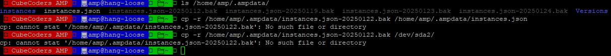

So I tried that and oddly enough I get an error that says that file does not exsists. Yet when I do ls/home/amp/ .ampdata/ I clearly see old json files.
You have a space in your command there
You have: /home/amp/ .ampdata/...
Where it should be: /home/amp/.ampdata/...
Space no space. I’ve tried probably tried 10 different ways for it to see it. Still nothing.
Should work fine. cd into the .ampdata directory and try it there, limit the possibilities for typos and such
