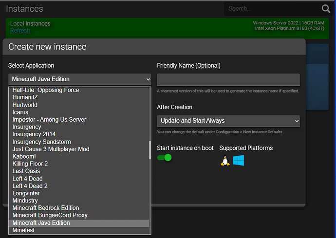

I mean the instance you created - I can’t see how it’s possible for AMP to report in its logs that a licence is present while also saying that the RunAMP feature isn’t present.
Im not sure how its possible to create an instance for McMyAdmin. I created a new instance directly from the drop down choosing Minecraft Java Edition. No where was it indicated to be for McMyAdmin.
