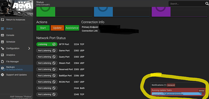

Error 429 (Too Many Requests) always i try to start the server
OS Name/Version: Debian 12
Product Name/Version: 2.6.3.2 - 20251022.1
Every time i start the server AMP try to update Arma 3 and after that i receive this error: Error 429 (Too Many Requests).
  • Press Start Button
  • AMP try to update Arma 3 server
  • AMP fail and server don’t start
I tried to change DNS to 8.8.8.8/8.8.4.4
I tried to reintall Linux and AMP
Extra: The problem is not on steamCMD update, but after that, see log bellow.
Log:

Image of the error:

The error you’re seeing isn’t a fault of AMP’s. It’s saying you’re requesting updates too often, likely from GitHub if I had to guess. Do you have a schedule setup or some other script querying it often? Usually you have to request a ton each hour to trigger that

I have the same problem... the instance is asking to update ARMA3 all the time. It only starts working again after I restart the AMP instance.
I believe it’s not steamCMD generating the 429 error, it’s something after it. You can see that at the second part of the log.

That was out of nowhere. If you want help I’m willing to help figure it out. You didn’t answer my original question though. How do you have the schedule setup? Show a screenshot. Give us something to work with rather than name calling. When I say it’s not AMP’s fault, I’m referring to the fact AMP itself isn’t giving the error, it’s most likely from a request to GitHub and their API limit that’s getting triggered.

Another (less obnoxious) user has worked out that it seems to be a GitHub issue specifically affecting Brazil (and maybe broader South America): Error: Response status code does not indicate success: 429 (Too Many Requests)
