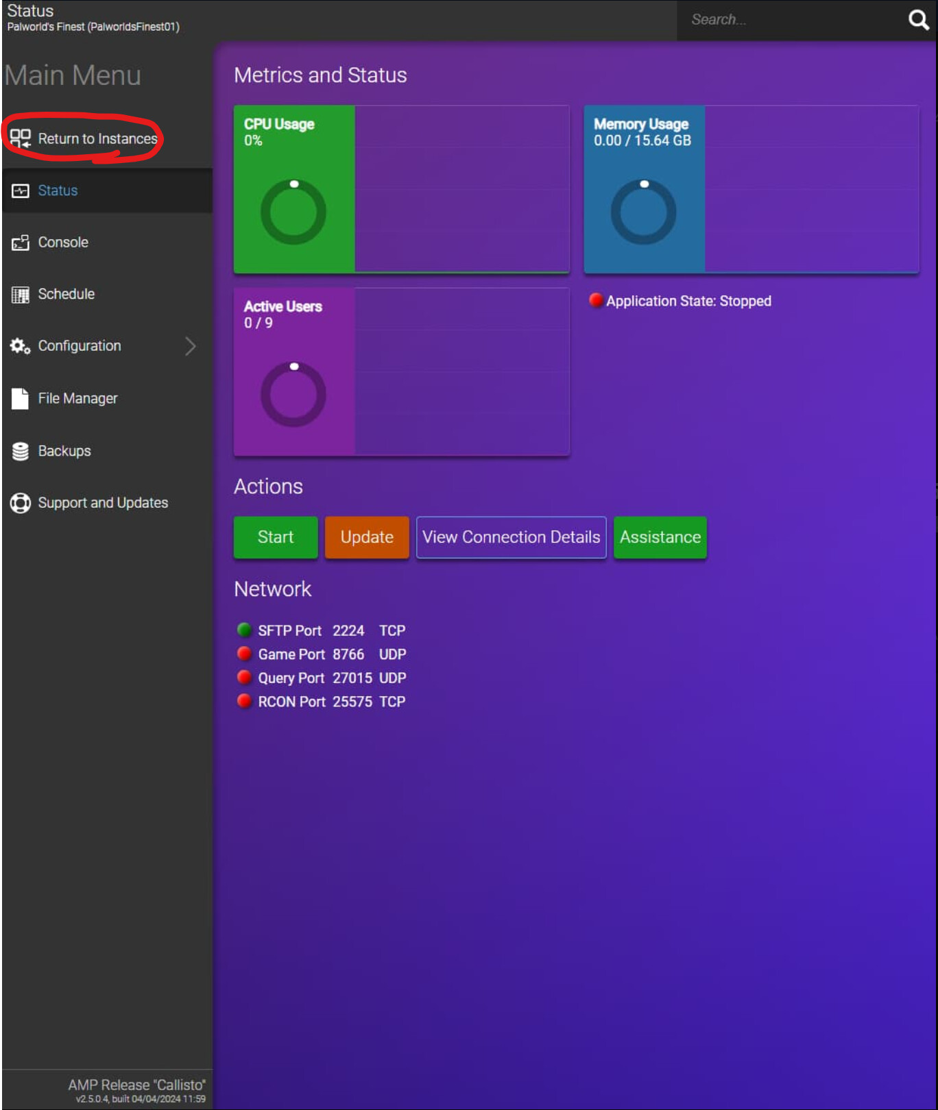

Screenshot pertaining to the next messages, this is the result.
Click Return to Instances.
Click Stop on the Palworld instance.
Click Update on the Palworld instance.

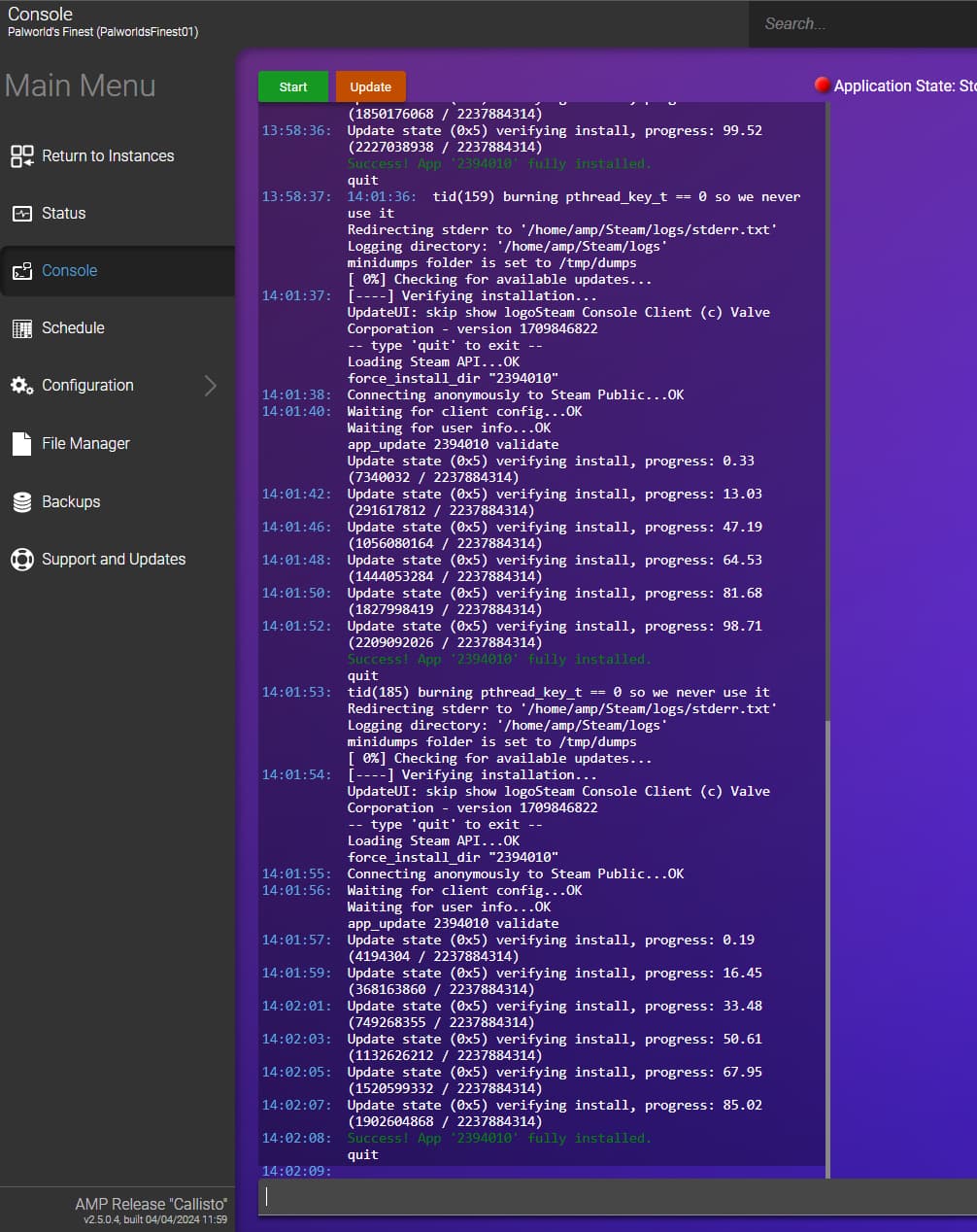

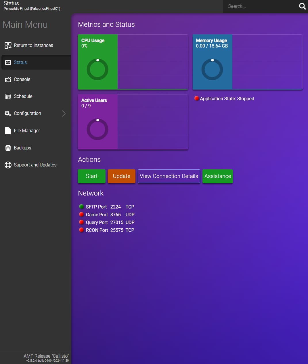

Thanks, these are the screenshots of what I’m doing and the results in order. I stopped the instance first. Then started it, it tried to update and I was left with this screen.
Pressing Start or Update results in this screen.

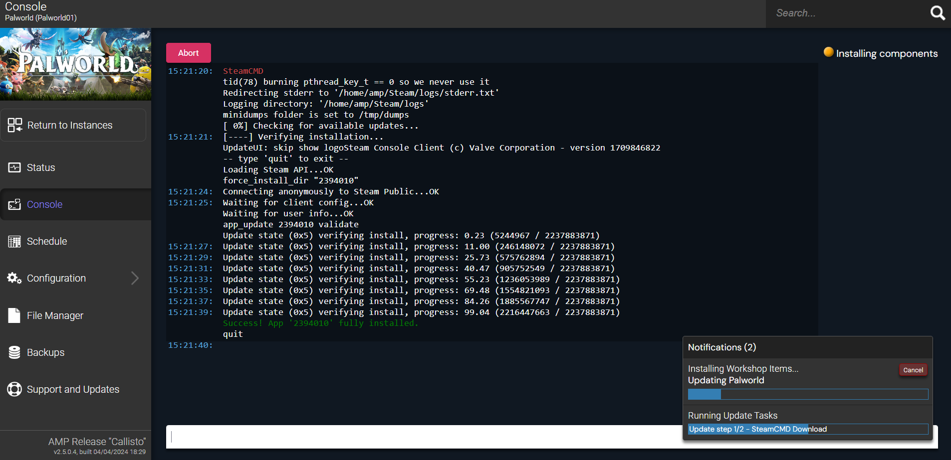

That loops back to the first screenshot again. The console show’s nothing that looks like an error but it does end with Quit and it never seems to update or launch the instance. So it just seems to loop. I will try edit the second screenshot onto the previous message as I can only attach one at a time.
I tried it many times and now it is stuck at updating Palworld and steamCMD is still half-loaded
