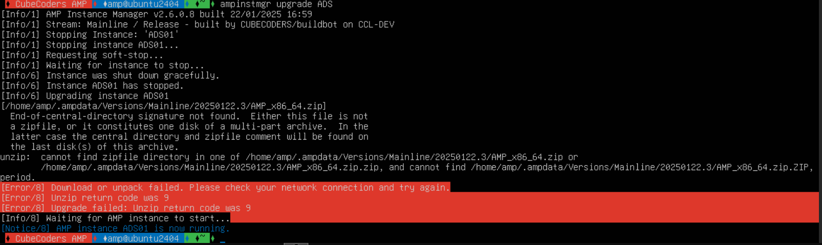

Tried to update the instance. Webservice goes offline. In some logs it is mentioned “already up to date”. Have to always manually restart ADS via console to get ADS back up running again in Browser
  • going to /support
  • Press Upgrade this instance
  • System goes down, never comes back up
  • Restart via console command “appinstmgr start ADS”
  • GUI via Web reachable again
