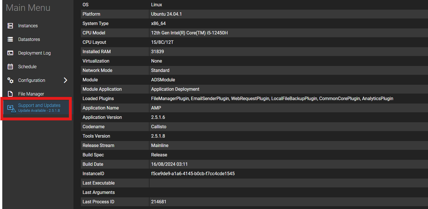

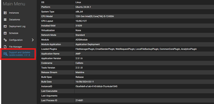

Hi guys,
Same with me on Debian Linux and Docker.
When clicking update, the system shuts down and never comes back.
I need to restart the main instance.
But no update was done. At least the AMP GUI still wants to do a update 2.5.1.8
Systems details see image.

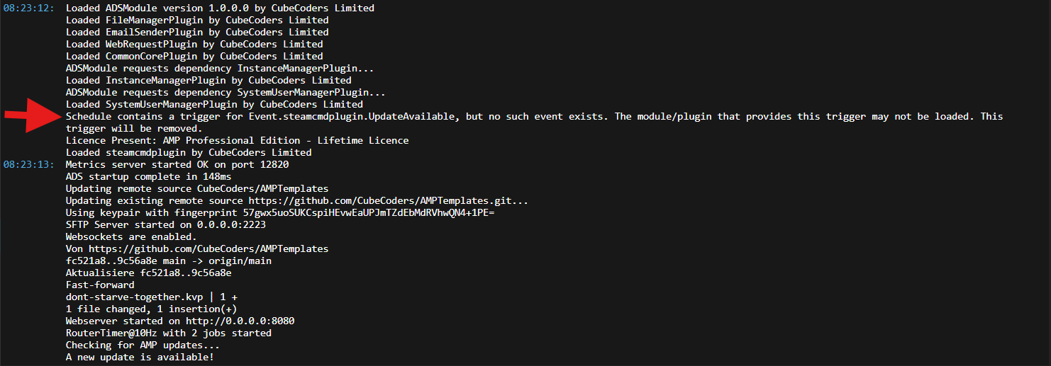

Update:
I checked the deployment log.
Maybe the line with the red arrow gives a hint, what is going wrong.
