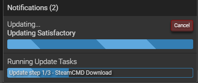

if i am update the server to the 1.0 of statisfactory then i am not can start the server
  • running the server correct
  • update server
  • restart the whole server
+1 same Problem starting results into updating and stopping
+1 infinite update loop after press start button

I also have this that always show up never saw the 2/3 or 3/3
it disapear and come back when i click start
Let me know if there is any progress.

not doing anything afther updating it dont start and at the end of the log it says batch
