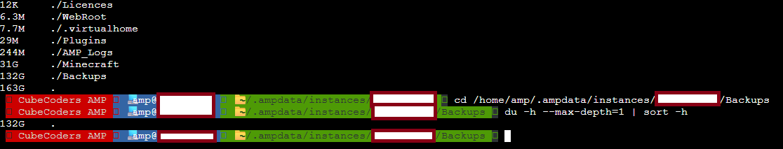

It’s still not showing me anything:
Alright, something’s clearly cloaking itself like a sneaky ninja in your backups directory. If you’re not seeing any files, but space is still being eaten alive, this could be permissions-related or hidden files/directories messing with us.

this is the output:
Okay, we’ve got confirmation now — your /Backups folder is there, it’s chunky, but it’s not showing files. That’s either hidden files, improper permissions, or dark Linux wizardry.
Here’s what we’ll do next to call out those files:
  1. Force reveal EVERYTHING (even if hidden):
    ls -lah /home/amp/.ampdata/instances/Minecraft01/Backups
    • This will spit out all files, their sizes, and permissions so we can sniff out any culprits.
  2. If we still get nothing, test who owns the folder and its contents by running:
    ls -ld /home/amp/.ampdata/instances/Minecraft01/Backups
    Look at the ownership—see if it’s “amp” or something else.
  3. Should it be a permissions issue, a quick fix for AMP’s custody problems:
    sudo su -
    ampinstmgr fixperms
These steps should finally reveal those “missing” files and tell us what’s eating all the space. Try this out and drop the findings here!
