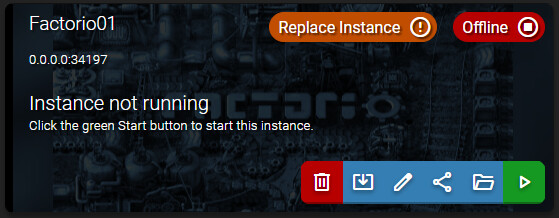

Affected instances will have a “Replace Instance” warning in their tile after the next AMP update:
Instances based on these modules will eventually stop working unless replaced with newer equivalents. And there may not be any warning when this happens as it will simply depend on how long those legacy modules survive the changes made to AMPs core over time.
