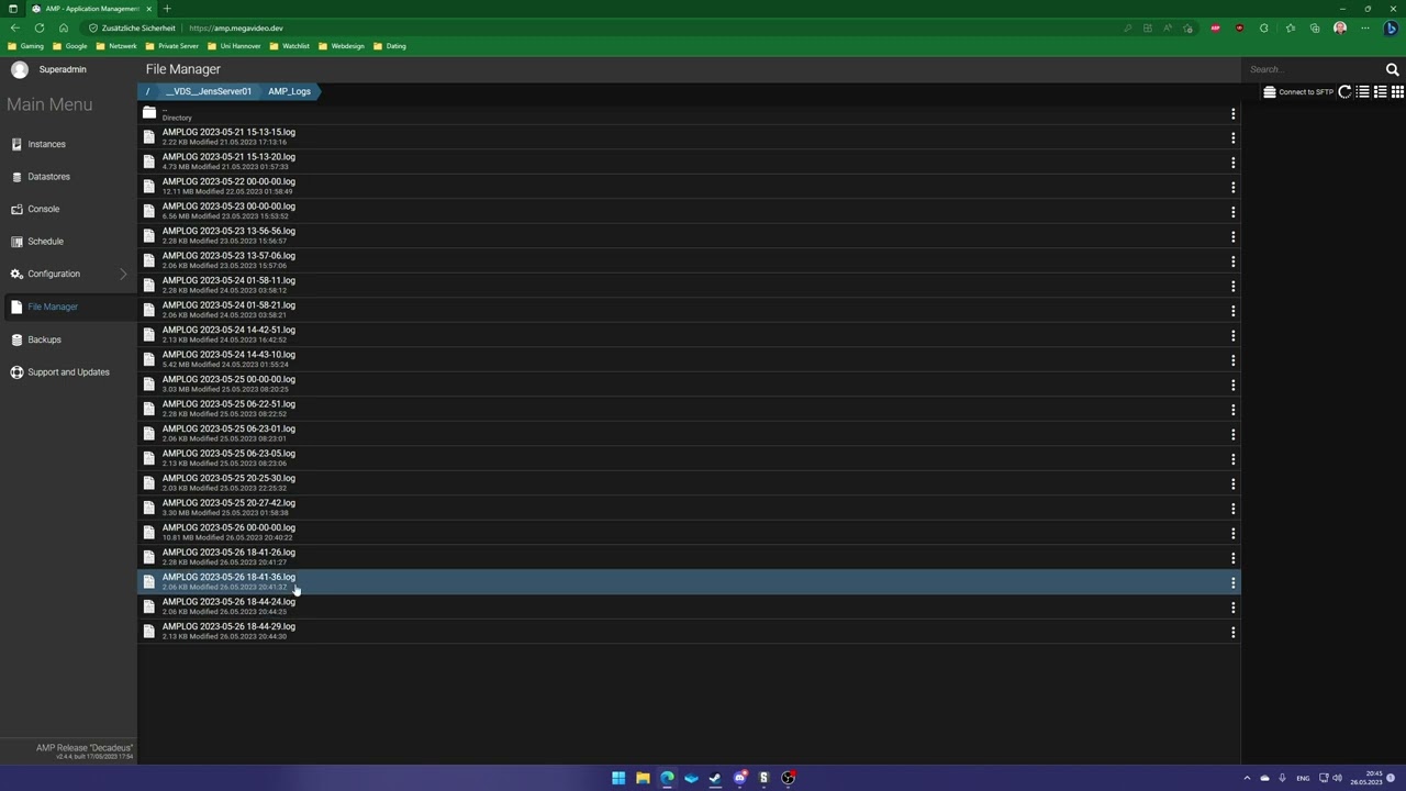

What do the logs of the actual instances say?
Instance Logs:
They are in order from oldest to newest.
The last log was generated after I inserted the license again.

AMPLOG 2023-05-09 09-40-30.log:
[09:40:30] [Logger Info]          : Starting AMP version 2.4.3.6 (Decadeus), built 07/05/2023 12:05
[09:40:30] [Logger Info]          : Stream: Mainline (Release) - built by CUBECODERS/buildbot on CCL-DEV
[09:40:30] [Logger Info]          : OS: Linux / x86_64
[09:40:30] [Logger Info]          : CPU: 11th Gen Intel(R) Core(TM) i5-11600 @ 2.80GHz (6C/12T)
[09:40:30] [Logger Info]          : RAM: 64119MB
[09:40:30] [Logger Info]          : AMP Instance ID: f943e140-5e39-4564-bddd-5db879b35199
[09:40:31] [Logger Error]         : Unable to load licence for AMP Network Standard - NoMatchingMachineId
[09:40:31] [Logger Info]          : Loaded MinecraftModule version 1.0.0.3 by CubeCoders Limited
[09:40:31] [Logger Info]          : Metrics publishing is enabled at udp://localhost:12820.
[09:40:31] [Logger Info]          : Loaded FileManagerPlugin by CubeCoders Limited
[09:40:31] [Logger Info]          : Loaded EmailSenderPlugin by CubeCoders Limited
[09:40:31] [Logger Info]          : Loaded WebRequestPlugin by CubeCoders Limited
[09:40:31] [Logger Info]          : Loaded LocalFileBackupPlugin by CubeCoders Limited
[09:40:31] [Logger Info]          : Loaded CommonCorePlugin by CubeCoders Limited
[09:40:31] [Logger Notice]        : Using keypair with fingerprint k/3vyH6+d1+wHnNjDsEIw2kItXYoO/YPTq4mJRdvIFA=
[09:40:31] [Logger Info]          : SFTP Server started on 0.0.0.0:2224
[09:40:31] [Logger Error]         : No valid AMP licence was found. Please open a shell as the 'amp' user and run `ampinstmgr reactivate Nemeseos01` to reactivate this instance.
AMPLOG 2023-05-09 09-46-12.log:
[09:46:12] [Logger Info]          : Starting AMP version 2.4.3.6 (Decadeus), built 07/05/2023 12:05
[09:46:12] [Logger Info]          : Stream: Mainline (Release) - built by CUBECODERS/buildbot on CCL-DEV
[09:46:12] [Logger Info]          : OS: Linux / x86_64
[09:46:12] [Logger Info]          : CPU: 11th Gen Intel(R) Core(TM) i5-11600 @ 2.80GHz (6C/12T)
[09:46:12] [Logger Info]          : RAM: 64119MB
[09:46:12] [Logger Info]          : AMP Instance ID: f943e140-5e39-4564-bddd-5db879b35199
[09:46:12] [Logger Error]         : Unable to load licence for AMP Network Standard - NoMatchingMachineId
[09:46:12] [Logger Info]          : Loaded MinecraftModule version 1.0.0.3 by CubeCoders Limited
[09:46:12] [Logger Info]          : Metrics publishing is enabled at udp://localhost:12820.
[09:46:12] [Logger Info]          : Loaded FileManagerPlugin by CubeCoders Limited
[09:46:12] [Logger Info]          : Loaded EmailSenderPlugin by CubeCoders Limited
[09:46:12] [Logger Info]          : Loaded WebRequestPlugin by CubeCoders Limited
[09:46:12] [Logger Info]          : Loaded LocalFileBackupPlugin by CubeCoders Limited
[09:46:12] [Logger Info]          : Loaded CommonCorePlugin by CubeCoders Limited
[09:46:12] [Logger Notice]        : Using keypair with fingerprint k/3vyH6+d1+wHnNjDsEIw2kItXYoO/YPTq4mJRdvIFA=
[09:46:12] [Logger Info]          : SFTP Server started on 0.0.0.0:2224
[09:46:12] [Logger Error]         : No valid AMP licence was found. Please open a shell as the 'amp' user and run `ampinstmgr reactivate Nemeseos01` to reactivate this instance.
AMPLOG 2023-05-09 09-46-17.log:
[09:46:17] [Logger Info]          : Starting AMP version 2.4.3.6 (Decadeus), built 07/05/2023 12:05
[09:46:17] [Logger Info]          : Stream: Mainline (Release) - built by CUBECODERS/buildbot on CCL-DEV
[09:46:17] [Logger Info]          : Loading configuration from provisionargs.kvp...
[09:46:17] [Logger Info]          : OS: Linux / x86_64
[09:46:17] [Logger Info]          : CPU: 11th Gen Intel(R) Core(TM) i5-11600 @ 2.80GHz (6C/12T)
[09:46:17] [Logger Info]          : RAM: 64119MB
[09:46:17] [Logger Info]          : AMP Instance ID: f943e140-5e39-4564-bddd-5db879b35199
[09:46:17] [Logger Error]         : Unable to load licence for AMP Network Standard - NoMatchingMachineId
[09:46:17] [Logger Info]          : Loaded MinecraftModule version 1.0.0.3 by CubeCoders Limited
[09:46:17] [Logger Info]          : Metrics publishing is enabled at udp://localhost:12820.
[09:46:17] [Logger Info]          : Loaded FileManagerPlugin by CubeCoders Limited
[09:46:17] [Logger Info]          : Loaded EmailSenderPlugin by CubeCoders Limited
[09:46:17] [Logger Info]          : Loaded WebRequestPlugin by CubeCoders Limited
[09:46:17] [Logger Info]          : Loaded LocalFileBackupPlugin by CubeCoders Limited
[09:46:17] [Logger Info]          : Loaded CommonCorePlugin by CubeCoders Limited
[09:46:17] [Core Info]            : -configonly specified or activation performed. Saving settings and shutting down. This is perfectly normal.
AMPLOG 2023-05-09 11-14-46.log:
[11:14:46] [Logger Info]          : Starting AMP version 2.4.3.6 (Decadeus), built 07/05/2023 12:05
[11:14:46] [Logger Info]          : Stream: Mainline (Release) - built by CUBECODERS/buildbot on CCL-DEV
[11:14:46] [Logger Info]          : OS: Linux / x86_64
[11:14:46] [Logger Info]          : CPU: 11th Gen Intel(R) Core(TM) i5-11600 @ 2.80GHz (6C/12T)
[11:14:46] [Logger Info]          : RAM: 64119MB
[11:14:46] [Logger Info]          : AMP Instance ID: f943e140-5e39-4564-bddd-5db879b35199
[11:14:47] [Logger Error]         : Unable to load licence for AMP Network Standard - NoMatchingMachineId
[11:14:47] [Logger Info]          : Loaded MinecraftModule version 1.0.0.3 by CubeCoders Limited
[11:14:47] [Logger Info]          : Metrics publishing is enabled at udp://localhost:12820.
[11:14:47] [Logger Info]          : Loaded FileManagerPlugin by CubeCoders Limited
[11:14:47] [Logger Info]          : Loaded EmailSenderPlugin by CubeCoders Limited
[11:14:47] [Logger Info]          : Loaded WebRequestPlugin by CubeCoders Limited
[11:14:47] [Logger Info]          : Loaded LocalFileBackupPlugin by CubeCoders Limited
[11:14:47] [Logger Info]          : Loaded CommonCorePlugin by CubeCoders Limited
[11:14:47] [Logger Notice]        : Using keypair with fingerprint k/3vyH6+d1+wHnNjDsEIw2kItXYoO/YPTq4mJRdvIFA=
[11:14:47] [Logger Info]          : SFTP Server started on 0.0.0.0:2224
[11:14:47] [Logger Error]         : No valid AMP licence was found. Please open a shell as the 'amp' user and run `ampinstmgr reactivate Nemeseos01` to reactivate this instance.
AMPLOG 2023-05-09 11-14-52.log:
[11:14:52] [Logger Info]          : Starting AMP version 2.4.3.6 (Decadeus), built 07/05/2023 12:05
[11:14:52] [Logger Info]          : Stream: Mainline (Release) - built by CUBECODERS/buildbot on CCL-DEV
[11:14:52] [Logger Info]          : Loading configuration from provisionargs.kvp...
[11:14:52] [Logger Info]          : OS: Linux / x86_64
[11:14:52] [Logger Info]          : CPU: 11th Gen Intel(R) Core(TM) i5-11600 @ 2.80GHz (6C/12T)
[11:14:52] [Logger Info]          : RAM: 64119MB
[11:14:52] [Logger Info]          : AMP Instance ID: f943e140-5e39-4564-bddd-5db879b35199
[11:14:52] [Logger Error]         : Unable to load licence for AMP Network Standard - NoMatchingMachineId
[11:14:52] [Logger Info]          : Loaded MinecraftModule version 1.0.0.3 by CubeCoders Limited
[11:14:52] [Logger Info]          : Metrics publishing is enabled at udp://localhost:12820.
[11:14:52] [Logger Info]          : Loaded FileManagerPlugin by CubeCoders Limited
[11:14:52] [Logger Info]          : Loaded EmailSenderPlugin by CubeCoders Limited
[11:14:52] [Logger Info]          : Loaded WebRequestPlugin by CubeCoders Limited
[11:14:52] [Logger Info]          : Loaded LocalFileBackupPlugin by CubeCoders Limited
[11:14:52] [Logger Info]          : Loaded CommonCorePlugin by CubeCoders Limited
[11:14:52] [Core Info]            : -configonly specified or activation performed. Saving settings and shutting down. This is perfectly normal.
AMPLOG 2023-05-09 11-15-09.log:
[11:15:09] [Logger Info]          : Starting AMP version 2.4.3.6 (Decadeus), built 07/05/2023 12:05
[11:15:09] [Logger Info]          : Stream: Mainline (Release) - built by CUBECODERS/buildbot on CCL-DEV
[11:15:09] [Logger Info]          : OS: Linux / x86_64
[11:15:09] [Logger Info]          : CPU: 11th Gen Intel(R) Core(TM) i5-11600 @ 2.80GHz (6C/12T)
[11:15:09] [Logger Info]          : RAM: 64119MB
[11:15:09] [Logger Info]          : AMP Instance ID: f943e140-5e39-4564-bddd-5db879b35199
[11:15:09] [Logger Error]         : Unable to load licence for AMP Network Standard - NoMatchingMachineId
[11:15:09] [Logger Info]          : Loaded MinecraftModule version 1.0.0.3 by CubeCoders Limited
[11:15:09] [Logger Info]          : Metrics publishing is enabled at udp://localhost:12820.
[11:15:09] [Logger Info]          : Loaded FileManagerPlugin by CubeCoders Limited
[11:15:09] [Logger Info]          : Loaded EmailSenderPlugin by CubeCoders Limited
[11:15:09] [Logger Info]          : Loaded WebRequestPlugin by CubeCoders Limited
[11:15:09] [Logger Info]          : Loaded LocalFileBackupPlugin by CubeCoders Limited
[11:15:09] [Logger Info]          : Loaded CommonCorePlugin by CubeCoders Limited
[11:15:09] [Logger Notice]        : Using keypair with fingerprint k/3vyH6+d1+wHnNjDsEIw2kItXYoO/YPTq4mJRdvIFA=
[11:15:09] [Logger Info]          : SFTP Server started on 0.0.0.0:2224
[11:15:09] [Logger Error]         : No valid AMP licence was found. Please open a shell as the 'amp' user and run `ampinstmgr reactivate Nemeseos01` to reactivate this instance.
AMPLOG 2023-05-09 11-15-32.log:
[11:15:32] [Logger Info]          : Starting AMP version 2.4.3.6 (Decadeus), built 07/05/2023 12:05
[11:15:32] [Logger Info]          : Stream: Mainline (Release) - built by CUBECODERS/buildbot on CCL-DEV
[11:15:32] [Logger Info]          : OS: Linux / x86_64
[11:15:32] [Logger Info]          : CPU: 11th Gen Intel(R) Core(TM) i5-11600 @ 2.80GHz (6C/12T)
[11:15:32] [Logger Info]          : RAM: 64119MB
[11:15:32] [Logger Info]          : AMP Instance ID: f943e140-5e39-4564-bddd-5db879b35199
[11:15:33] [Logger Error]         : Unable to load licence for AMP Network Standard - NoMatchingMachineId
[11:15:33] [Logger Info]          : Loaded MinecraftModule version 1.0.0.3 by CubeCoders Limited
[11:15:33] [Logger Info]          : Metrics publishing is enabled at udp://localhost:12820.
[11:15:33] [Logger Info]          : Loaded FileManagerPlugin by CubeCoders Limited
[11:15:33] [Logger Info]          : Loaded EmailSenderPlugin by CubeCoders Limited
[11:15:33] [Logger Info]          : Loaded WebRequestPlugin by CubeCoders Limited
[11:15:33] [Logger Info]          : Loaded LocalFileBackupPlugin by CubeCoders Limited
[11:15:33] [Logger Info]          : Loaded CommonCorePlugin by CubeCoders Limited
[11:15:33] [Logger Notice]        : Using keypair with fingerprint k/3vyH6+d1+wHnNjDsEIw2kItXYoO/YPTq4mJRdvIFA=
[11:15:33] [Logger Info]          : SFTP Server started on 0.0.0.0:2224
[11:15:33] [Logger Error]         : No valid AMP licence was found. Please open a shell as the 'amp' user and run `ampinstmgr reactivate Nemeseos01` to reactivate this instance.
AMPLOG 2023-05-09 11-18-31.log:
[11:18:31] [Logger Info]          : Starting AMP version 2.4.3.6 (Decadeus), built 07/05/2023 12:05
[11:18:31] [Logger Info]          : Stream: Mainline (Release) - built by CUBECODERS/buildbot on CCL-DEV
[11:18:31] [Logger Info]          : Loading configuration from provisionargs.kvp...
[11:18:31] [Logger Info]          : OS: Linux / x86_64
[11:18:31] [Logger Info]          : CPU: 11th Gen Intel(R) Core(TM) i5-11600 @ 2.80GHz (6C/12T)
[11:18:31] [Logger Info]          : RAM: 64119MB
[11:18:31] [Logger Info]          : AMP Instance ID: f943e140-5e39-4564-bddd-5db879b35199
[11:18:31] [Logger Error]         : Unable to load licence for AMP Network Standard - NoMatchingMachineId
[11:18:31] [Logger Info]          : Loaded MinecraftModule version 1.0.0.3 by CubeCoders Limited
[11:18:31] [Logger Info]          : Metrics publishing is enabled at udp://localhost:12820.
[11:18:31] [Logger Info]          : Loaded FileManagerPlugin by CubeCoders Limited
[11:18:31] [Logger Info]          : Loaded EmailSenderPlugin by CubeCoders Limited
[11:18:31] [Logger Info]          : Loaded WebRequestPlugin by CubeCoders Limited
[11:18:31] [Logger Info]          : Loaded LocalFileBackupPlugin by CubeCoders Limited
[11:18:31] [Logger Info]          : Loaded CommonCorePlugin by CubeCoders Limited
[11:18:31] [Core Info]            : Performing activation, please wait...
[11:18:32] [Core Info]            : Activated successfully.
[11:18:32] [Logger Info]          : Licence Present: AMP Network Standard Edition
[11:18:32] [Core Info]            : -configonly specified or activation performed. Saving settings and shutting down. This is perfectly normal.
AMPLOG 2023-05-09 11-19-39.log:
[11:19:39] [Logger Info]          : Starting AMP version 2.4.3.6 (Decadeus), built 07/05/2023 12:05
[11:19:39] [Logger Info]          : Stream: Mainline (Release) - built by CUBECODERS/buildbot on CCL-DEV
[11:19:39] [Logger Info]          : OS: Linux / x86_64
[11:19:39] [Logger Info]          : CPU: 11th Gen Intel(R) Core(TM) i5-11600 @ 2.80GHz (6C/12T)
[11:19:39] [Logger Info]          : RAM: 64119MB
[11:19:39] [Logger Info]          : AMP Instance ID: f943e140-5e39-4564-bddd-5db879b35199
[11:19:40] [Logger Info]          : Loaded MinecraftModule version 1.0.0.3 by CubeCoders Limited
[11:19:40] [Logger Info]          : Metrics publishing is enabled at udp://localhost:12820.
[11:19:40] [Logger Info]          : Loaded FileManagerPlugin by CubeCoders Limited
[11:19:40] [Logger Info]          : Loaded EmailSenderPlugin by CubeCoders Limited
[11:19:40] [Logger Info]          : Loaded WebRequestPlugin by CubeCoders Limited
[11:19:40] [Logger Info]          : Loaded LocalFileBackupPlugin by CubeCoders Limited
[11:19:40] [Logger Info]          : Loaded CommonCorePlugin by CubeCoders Limited
[11:19:40] [Logger Info]          : Licence Present: AMP Network Standard Edition
[11:19:40] [Logger Notice]        : Using keypair with fingerprint k/3vyH6+d1+wHnNjDsEIw2kItXYoO/YPTq4mJRdvIFA=
[11:19:40] [Logger Info]          : SFTP Server started on 0.0.0.0:2224
[11:19:40] [Webserver Info]       : Websockets are enabled.

Is there some way to lock the License to a machine without asking for a new check?
Sometimes the License Key stays there and I have to hit reactivate, sometimes this form is empty and I have to fill it by copy and pasting it.
I just activated all instances again. If the error occours next time I will do a video and show you everything maybe that helps a bit more.
If you turn on debug logging (Monitoring.LogLevel=0 in AMPConfig.conf) you’ll get more information on what’s happening. You’ll want to turn this on for both ADS and the instances.
It says there’s no matching machine ID but I can’t see why that’d be the case inside a Docker instance though…
I’ve turned debug logging on like you said. When the nex crash happens you will get the log.
Also there is my video that showcases my problem (the crash occured today at around 20:41/42 German time).
Here are the latest logs after the instance crashed again today:

Update:
License key disappeared:
What are the logs immediately before crashing?
I feel like the licence being lost is more of a symptom of something else going on, so I’m interested in finding out what’s going on here.
