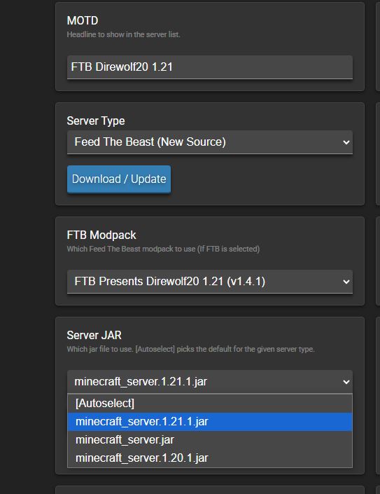

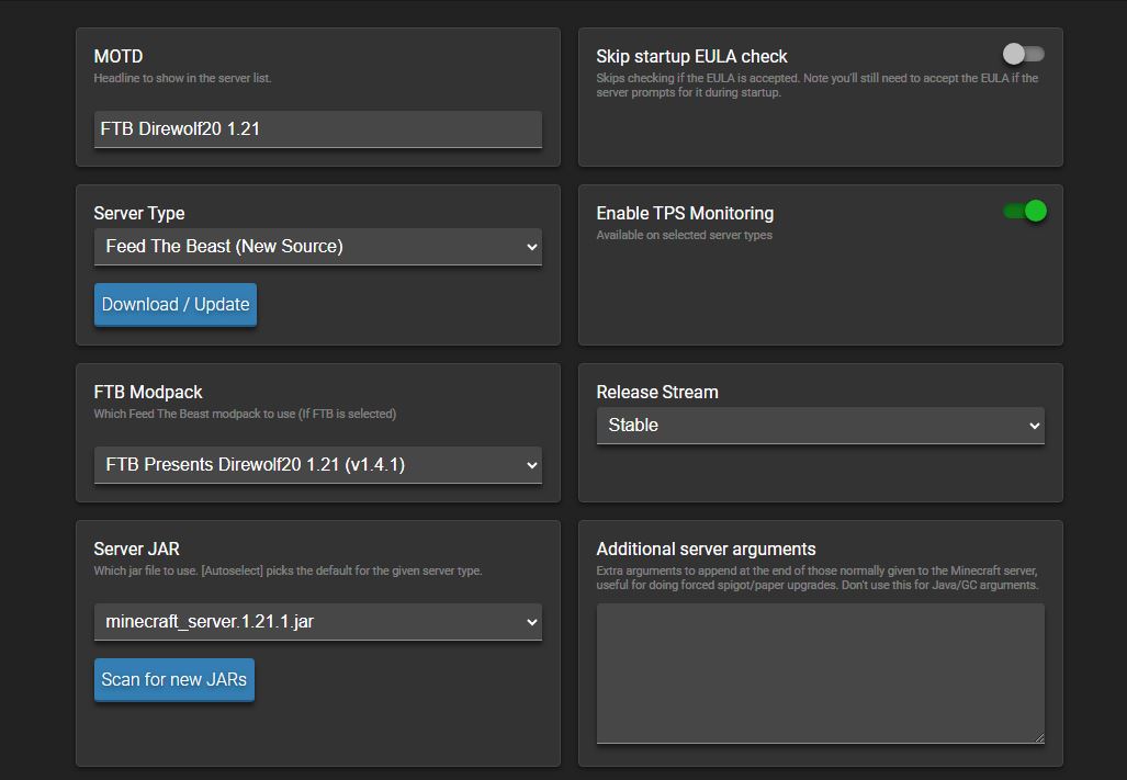

Minecraft server is configured using the FTB server type
FTB modpack selected : FTB direwolf20 1.21 (v1.4.1)
Server Jar: mincraft_server_1.21.jar
Unable to use auto select as it tried to use the most recent minecraft 1.21.4 version

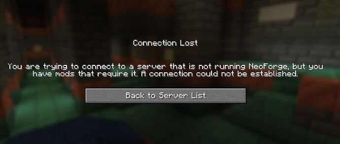

Log into server on client and get neoforge loader error as seen in screenshot
Neoforge jars are installed
Current configuration
Unable to determine what is causing the issue. tried leaving the server jar set to auto select and it runs 1.21.4, loading up direwolf20 using FTB launcher shows it’s the wrong version in the server list
I have pulled the server file directly from FTB and installed those files, no changes to the files.

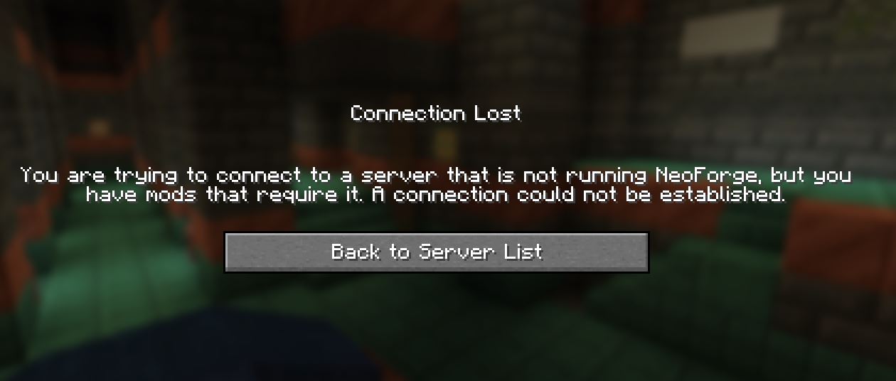

Having the exact same issues. exactly as described. I have gone through the full setup of this 6 times now to make sure I have done everything I can. Stop started the server completely rebooted the machine

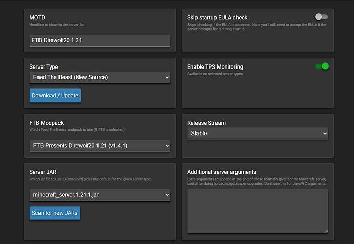

After downloading the pack you need to set the Server Type to NeoForge and select the right NeoForge version.

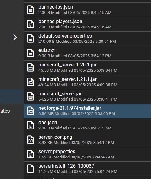

Still not working I changed it to neoforge and 21.1.97 and now it will not start Now it just gives
Error: could not open `libraries/net/neoforged/neoforge/21.1.97/unix_args.txt’

Went back to minecraft config changed it to Neoforge and the 21.1.97 versions. Back to console and told it up update it updated.
Went to file manger and deleted the mods folder, recreated the mods folder, and then uploaded all the mods from the local client.

That means that the mods probably aren’t loaded on the server, you’ll want to make sure that all of the mod .jar files are in the mods folder
The FTB download source was changed on FTB’s end yet again, so with some of the newer packs that have been updated since you have to download and run the FTB installer on your computer, and then upload the mod files to AMP. (either way, AMP is due for an overhaul on the mod-handling side of things when time permits and Mike+Ice can get something sorted out)
