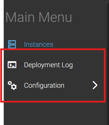

hello, thank you - it works now. one more thing. how can i remove the two points marked in the screenshot from the customer? Deployment Log and Configuration should not appear.
amp2
Double check that you’ve given them zero permissions at the top level, besides the manage permission.
They should not have permissions to view the ADS’s “console” (which is that Deployment Log), and they shouldn’t have access to settings.
You can go into the configuration tab there and see what permissions you might’ve accidentally given them.
You could also check in an incognito tab in case it’s your browser’s cache holding onto things
thanks for your help, i have now checked several times. on ads level controller and target all permissions are grayed out - except for the manage permission. the two points deployment log and configuration still appear. in the configuration tab everything is empty, no entry, but still present (would not be so bad). the deployment log also contains the complete log of other users and my super admin. i have also checked with an ikognito tab and cleared the cache, but these two tabs still appear. i will now test inden i create a new template with the same settings - or does anyone else have an idea?

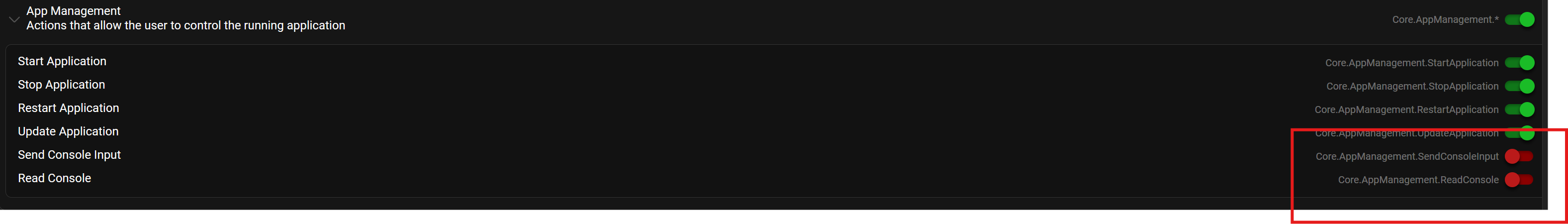

That is a bit odd. What if you remove the View Console permission from the user’s role inside the game server instance? If that prevents them from seeing the ADS’s console that could be the cause, and would be a bug in AMP
yes it is. if i remove the view console at instance level, it is no longer visible… is that a bug?
then i’ve recently had another problem with the file manager. it suddenly appears in the ads again. if i remove the file manager at instance level, it also disappears again.
i would like to allow users to use the console and the file manager, but only at instance level and not ads
Yeah that would be a bug with how AMP is handling the Template Role, for the time being you can disallow users from managing the ADS, then give them the direct URL to their instances (as explained in the guide)
