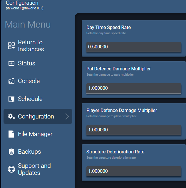

Once you click on the instance in AMP and click “Manage” one of the options on the side panel should be “Configuration” inside the web UI. This is the configuration settings that override the actual config files in the file manager section of AMP.
I’m not super familiar with setting up AMP as our friend is the one hosting it and setting it up, so our platform may differ from yours a bit, but I’m administering the server itself from AMP.
This is what ours looks like.
and the settings themselves that appear under Configuration look like this. I had to change the multiplier settings as well as gameplay settings to get things how we wanted it. Changed them there, restarted the server, and when I checked back in on the config text files after doing that, it had finally overwritten the values inside the config.
