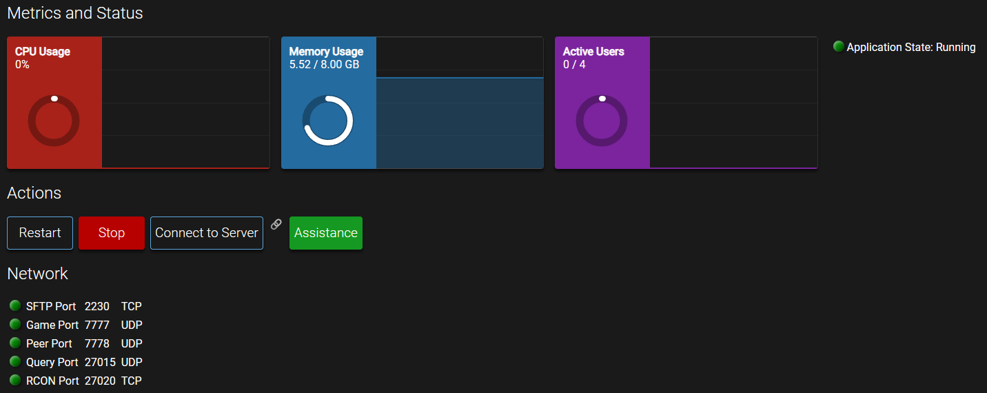

You already check the Ports and all are green on the Instance Status?
SFTP Port 2230 TCP
Game Port 7777 UDP
Peer Port 7778 UDP
Query Port 27015 UDP
RCON Port 27020 TCP
Everything is green but the server doesn’t appear in the public server list?

Everything is green, I have a dedicated server that isn’t on the same network as me.

I figured it out.
for some reason it as using a internal IP.
