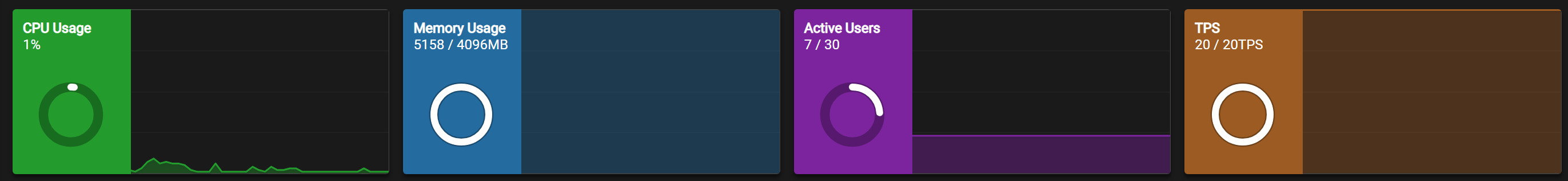

And its running now no disconnects but the usage repported is way above the settings?
I have never had above 10 users on the server
So do I need some extra settings? or is AMP just needing more RAM?
Thanks for a great product! MineOS caused me so many other problems!
And your search function is a life saver!
Nothing is wrong here and this is normal. There’s no such thing as a ‘memory limit’ - what you’re setting is javas maximum heap size for the java virtual machine. Java also has its own overheads on top of that.

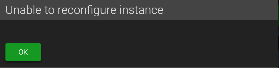

I just changed my CPU cores and my RAM to higher settings on my VM and now I get this message when trying to change the boot to autostart?
Is this some Software security because AMP thinks I am running on new HW?
Quite possibly, check that instances logs to see what’s up.

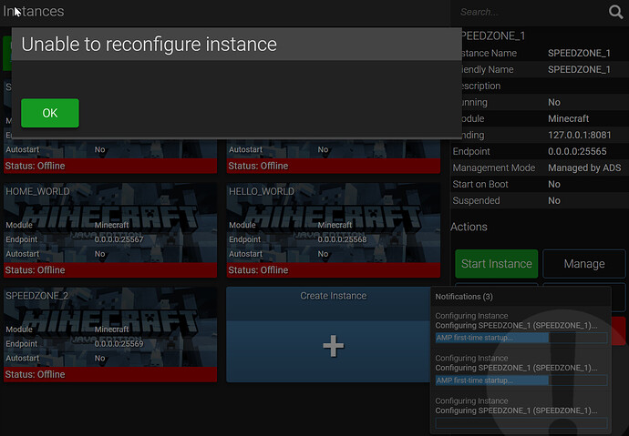

So after trying to set auto start in the UI I get this notification (That never goes away)

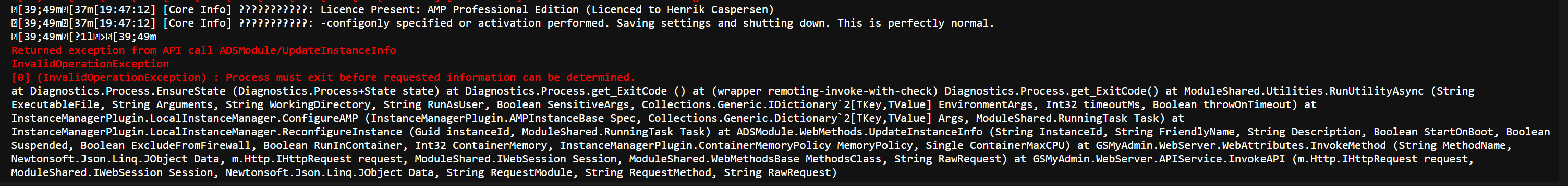

And the logs after the reboot dont say much?
[20:19:34] [Core Info]            : Running in a Docker environment.
[20:19:34] [Core Info]            : OS: Linux / x86_64
[20:19:34] [Core Info]            : CPU: Intel(R) Xeon(R) E-2176G CPU @ 3.70GHz (2C/4T)
[20:19:34] [Core Info]            : AMP Instance ID: 122ca383-303b-4f0e-bc11-1d0d30823cdf
[20:19:35] [ModuleLoader Info]    : Loaded MinecraftModule version 1.0.0.3 by CubeCoders Limited
[20:19:35] [Core Info]            : Metrics publishing is enabled at udp://localhost:12820.
[20:19:35] [ModuleLoader Info]    : Loaded FileManagerPlugin version 1.0.0.0 by CubeCoders Limited
[20:19:35] [ModuleLoader Info]    : Loaded EmailSenderPlugin version 1.0.0.0 by CubeCoders Limited
[20:19:35] [ModuleLoader Info]    : Loaded WebRequestPlugin version 1.0.0.0 by CubeCoders Limited
[20:19:35] [ModuleLoader Info]    : Loaded LocalFileBackupPlugin version 1.0.0.0 by CubeCoders Limited
[20:19:35] [ModuleLoader Info]    : Loaded CommonCorePlugin version 1.0.0.0 by CubeCoders Limited
[20:19:35] [Core Error]           : Invalid setting node: CustomPort
[20:19:35] [Core Info]            : Licence Present: AMP Professional Edition (Licenced to Henrik Caspersen)
[20:19:35] [Core Info]            : -configonly specified or activation performed. Saving settings and shutting down. This is perfectly normal.
I cant see it writes anything after me trying to change the settings?

The game servers run fine! But I cant change “Auto start in settings” on any of the servers
Just tried to change settings to “suspend” I got the same error but it did suspend the server?
The notifications are there because it cant update any changes to the settings
only a complete reboot stops the notifications

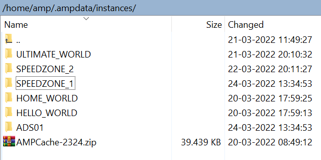

If the files aren’t there under “Instances” then something has gone wrong with your system and deleted the instance data.
Instances (show hidden files)
This is what I see under instances
That’s fine then - so you want to look in the ADS01 log files.

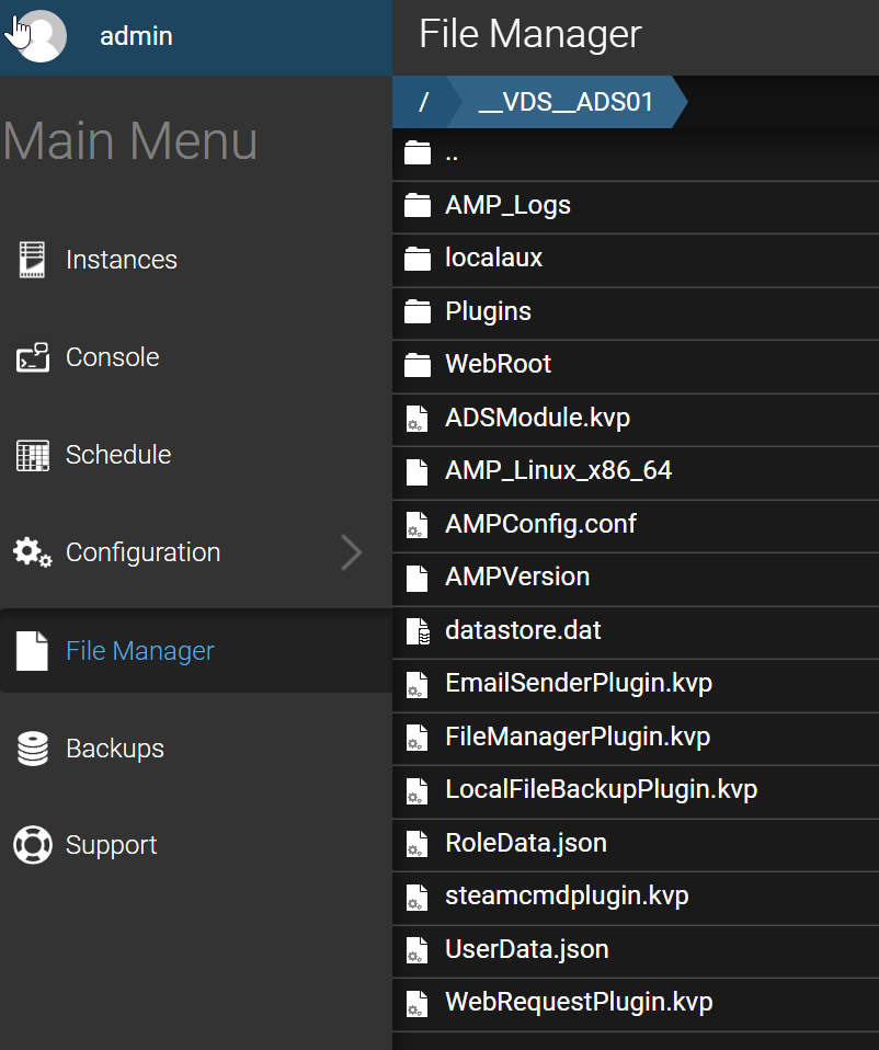

These logs are accessible in the web interface, but only via the file manager.
So try and do the reconfiguration again, and check the latest log file for ADS.
Sorry Mike I can only see the AMP_logs in the File manager UI (That I also pasted above)
No ADS logs?
ADS is the name of the instance, ADS01. You want to look at AMP_Logs inside the ADS instance.
