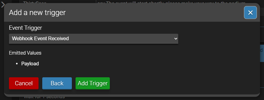

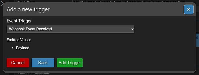

Webhooks are integrated with the scheduler as a trigger:
The trigger emits a single parameter called Payload which contains the value of the Payload field from the request JSON body.
Adding a task to the hook.

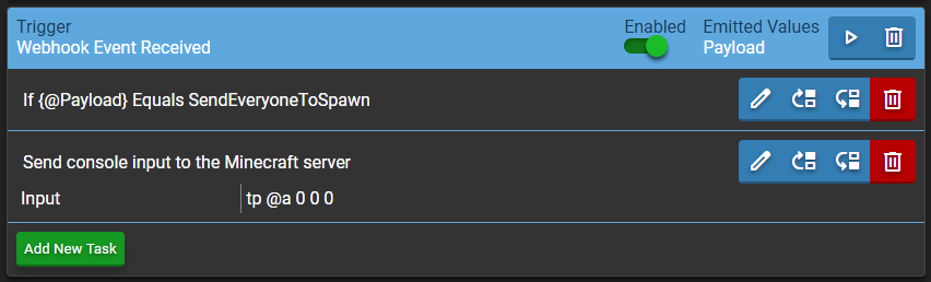

We can then perform certain tasks in response to the Payload.
In the below example, the “If a condition is met” task is used to filter the payload, and only send the console command if that specific value is sent. You can follow this up with the “Else if” task to accomodate multiple different values.
While you could send the Payload value directly, doing this requires additional steps are taken to secure the webhook

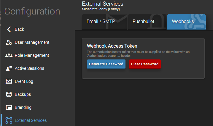

Securing the webhook with a bearer token
If you need or want to accept webhook pushes from external sources or otherwise expose it, you will need to generate a bearer token from the configuration:
Keep hold of this generated value as you will not be able to retrieve it again.

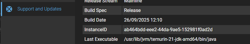

The first thing you will need is the Instance ID for the instance you want to send the webhooks to. This can be found under Support and Updates:

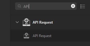

Once the plugin is installed, you can use the API Request action:

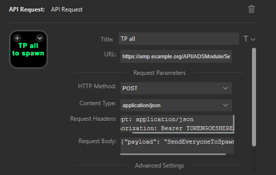

Which can then be configured using the same values as above:
This will then trigger this hook (and subsequent schedule tasks) once the button is pressed.
