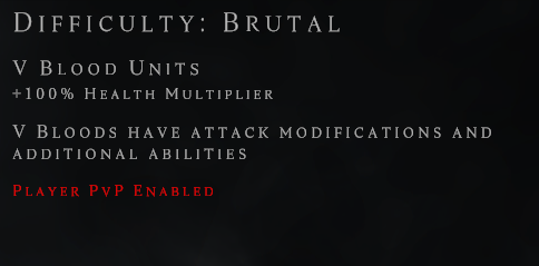

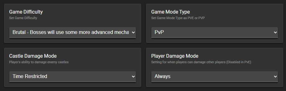

I’m trying to set the “Castle Damage Mode” configuration to “TimeRestricted” on the AMP panel but it just won’t work. The configuration file (ServerGameSettings.json) always stay on “Never” even if I change on the AMP panel. My current game is setted on the “Brutal” difficulty and on the game says that is on “Brutal” dif too, but, the json it says “Normal”. So I believe that changes made into this file are not applied. The thing is… Even when I set the “TimeRestricted” on AMP it’s stil “Always” inside the game. Is there any file that I can change this setting?
How it shows inside the game:
  • Step 1
    Change the CastleDamageMode to “Time Restricted”
  • Step 2
    Restart the server

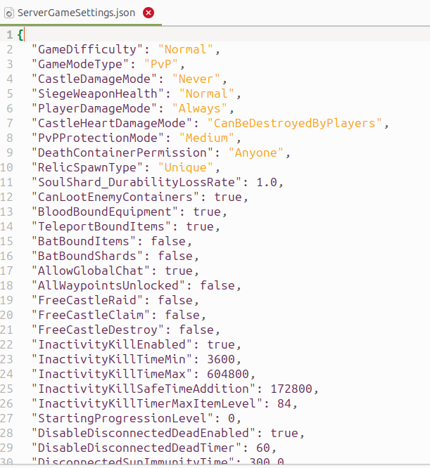

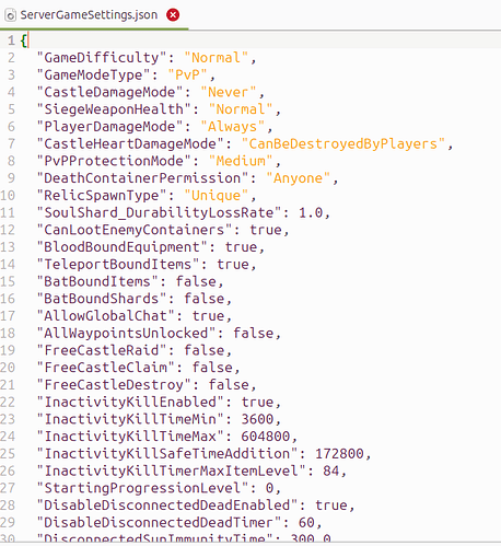

Tried to modify the servergamesettings.json file. Restarted the server. Turn if off and on again.
You’ve probably broken your config file permissions so AMP can’t write to it anymore. Don’t use the Windows Explorer
I’m not using Windows but Linux (with a GUI).
The only thing that I did was to create the voip file.
The json settings was not modified at all but it never has been the same as the AMP panel
Perms could still be broken if you are manipulating the files outside amp
You’d have to turn on debug logging in the instance, try to change the settings via the UI, then check the Amp logs to see what might be the issue
