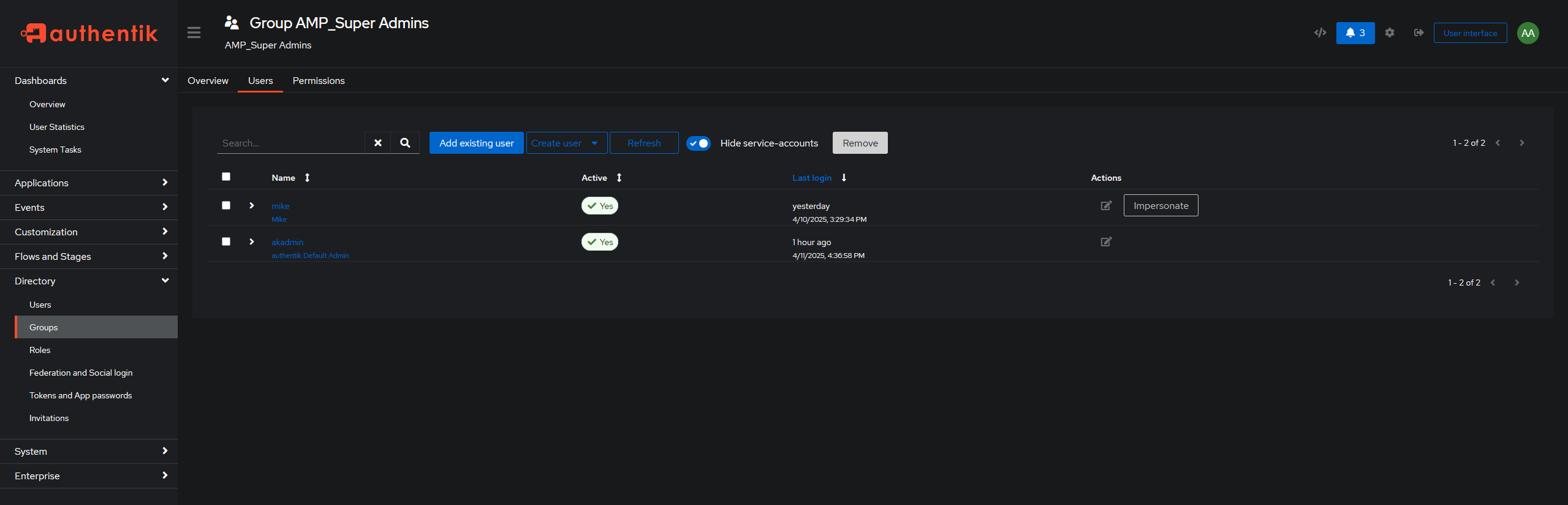

Create a group called
AMP_Super Adminswhich contains all your administrators. The default prefix isAMP_and the rest should match the Role Name from AMP. This is how AMP knows which groups the user should have when logging in.
