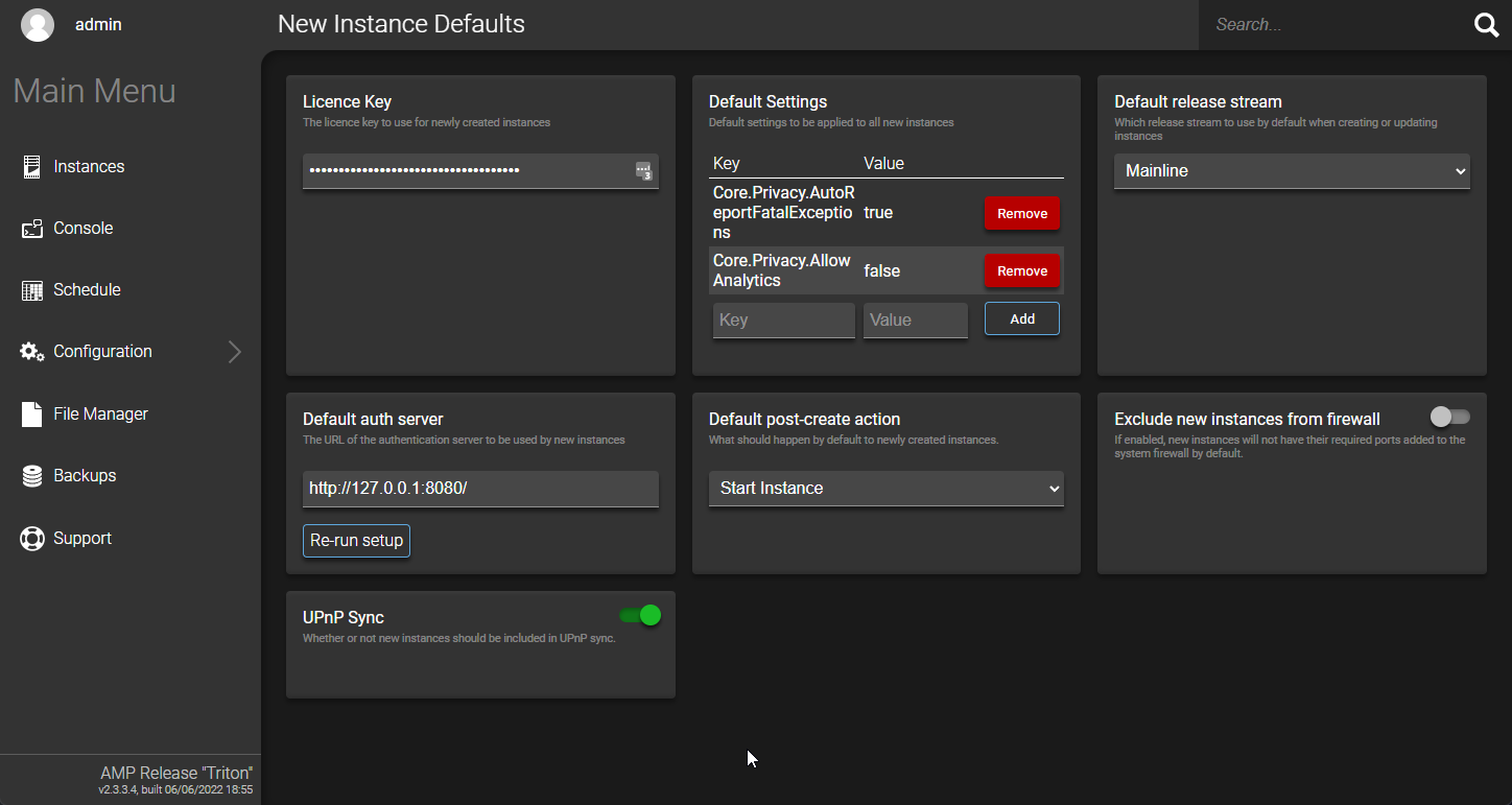

I enabled the UPNP sync. Upgraded the instances and restarted them. Checked my router and it did not forward the ports via UPNP. Other applications have port forwarding working within the network.

Still no UPNP Syncing :frowning: I did confirm the setting was still enabled.
