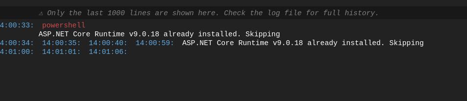

Take a look at the console. What does it say?
I have the same problem except I’m on Linux. Should i create my own ticket or I can post the info here?

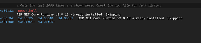

This is all that is showing in the console.
And if you press Update again?
Same thing.
It gets to step 7/10 it looks like. Which is Fika Download and give the same error
Thing is though I’m not seeing any error. Just a freeze? Can you send the entire latest AMP_Log? You can find it at the folder icon on your instance, inside the AMP_Logs directory. Use pastebin or similar
