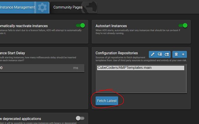

Seems like you’re missing the latest templates. Try to Fetch Latest from the configuration section with the configuration repositories. Maybe you also need to delete the CubeCoders directory within the DeploymentTemplates directory. Possibly they are named differently. I don’t have the names at hand.

Use the search bar of AMP to find the configuration repositories section. Do you have any other repos configured than the cubecoders one?
I used the Fetch Latest option in the Configuration Repositories section and restarted AMP, but I still can’t update these two instances. The error persists:
