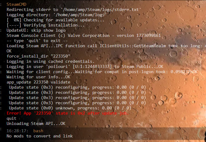

When i try updating, it doesn’t work at all. i can’t start the server. It’s a fresh fresh install. Update state (0x3) reconfiguring, progress: 0.00 (0 / 0)
  • Start dayz
  • Update dayz
  • Get the error
[  0%] Checking for available updates...
19:14:58
UpdateUI: skip show logo
Steam Console Client (c) Valve Corporation - version 1769026246
-- type 'quit' to exit --
Loading Steam API...OK
force_install_dir "223350"
Logging in using cached credentials.
19:14:59
Waiting for user info...OK
app_update 223350 validate
19:15:01
19:15:03
19:15:05
19:15:07
19:15:09
 Update state (0x0) unknown, progress: 0.00 (0 / 0)
Error! App '223350' state is 0x2 after update job.
19:15:10
quit
Unloading Steam API...OK
19:15:11
bash19:15:12
No mods to convert and link
Try deleting the steamapps directory in the instance file manager and update the server again

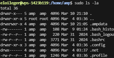

ls -la
You have lots there
Yup. But how do i get dayz working? Do i need to reinstall amp entirely? I could, i only want to save 1 instance. If you told me how to completely uninstall it and then reinstall it. If i have no other options

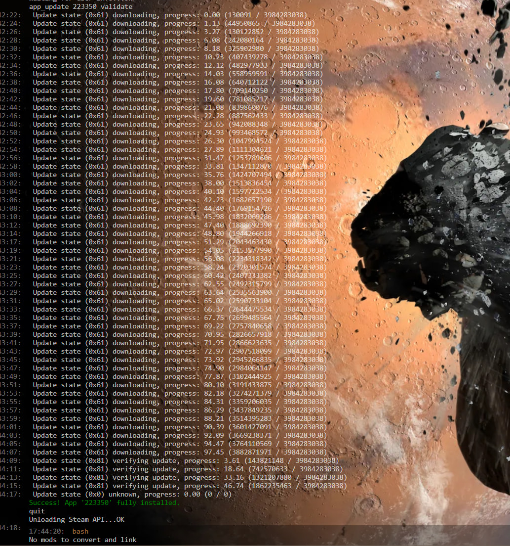

Disable IPv6 completely on your server and SteamCMD will then work
I tried to, but still didn’t work, i’ll retry and tell you if it works in 5 minutes
Guess what… It worked. When i tried, i deactivated it directly inside the docker container, but yeah, i saw that the ovh ipv6 was horrible. It’s probably better that way. Thank you very much for your help!!
