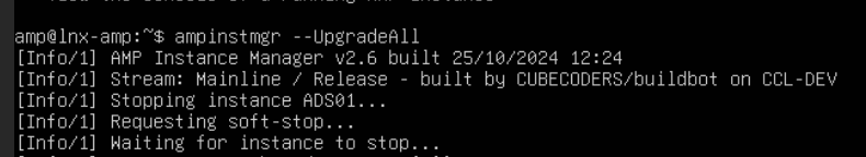

Just updated it, go in commandline and type ampinstmgr --UpgradeAll It will restart all your instances so be aware and upgrade them.
kind of embarressed to ask, but where exactly do i find the commandline? I just see the deployment log and not a real commandline.
I meant like go onto your debian linux machine running AMP and type it
awesome, thank you so much
