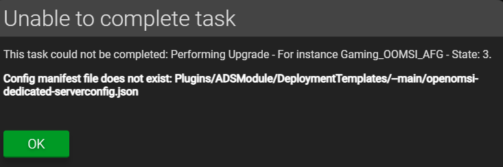

Instance update fails with Config manifest file does not exist: Plugins/ADSModule/DeploymentTemplates/–main/config.json after updating the source files on GitHub and fetching the repo again in AMP. Restarting the instance does not resolve it.
Repository GitHub - papiscze/omsi-multiplayer-amptemplate · GitHub (branch: main) Custom Generic Module templates for two dedicated server apps in the same repo (openOMSI, neoOMSI), following the standard AMPTemplates layout (manifest.json + flat template files in the repo root, no subdirectories). The config/metaconfig JSON files were drafted with Claude’s help (AI-assisted) and tested against the actual server binaries/generated server.cfg before use, per the AMPTemplates contribution guidelines - mentioning this in case it’s relevant to narrowing down the cause, though the file structure and JSON themselves validate fine and the same error occurs regardless of which file was last edited.
Error
Plugins/ADSModule/DeploymentTemplates/–main/openomsi-dedicated-serverconfig.json

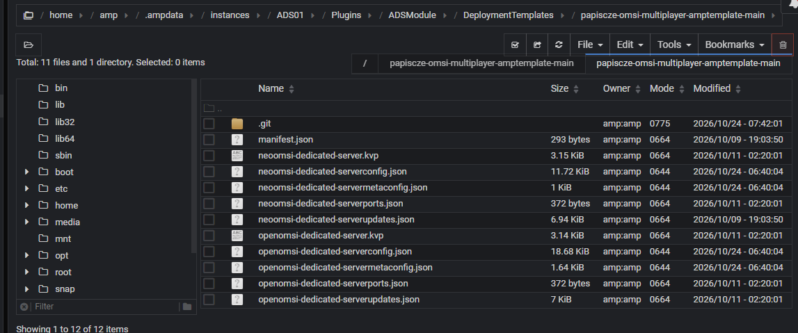

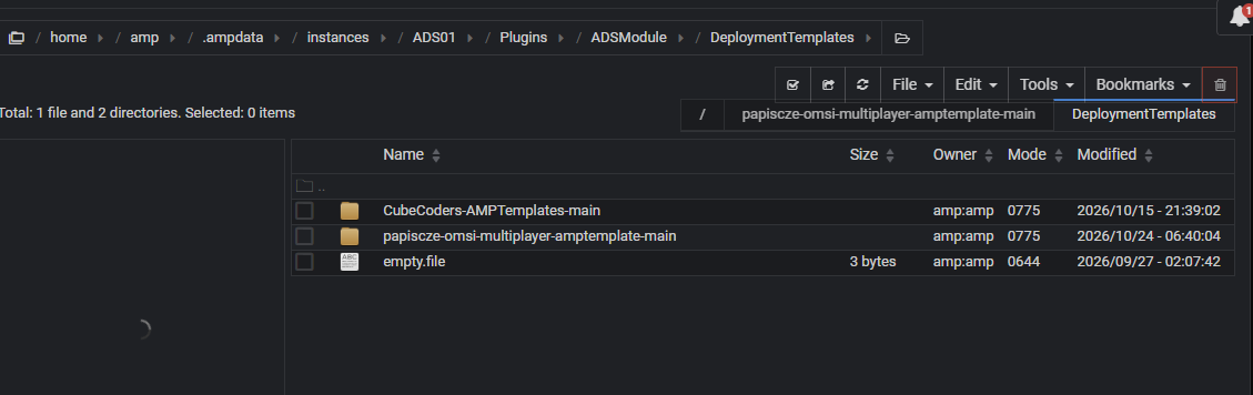

Note the path: --main (empty-empty-main), not the expected – folder name (which on disk is papiscze-omsi-multiplayer-amptemplate-main, confirmed to exist via ls).

Attempt to update an existing instance running this template (e.g. via the instance’s Update button, or ampinstmgr).
The update fails with the --main path error above.

The files physically exist in the correct on-disk folder after fetch: …/DeploymentTemplates/papiscze-omsi-multiplayer-amptemplate-main/.
