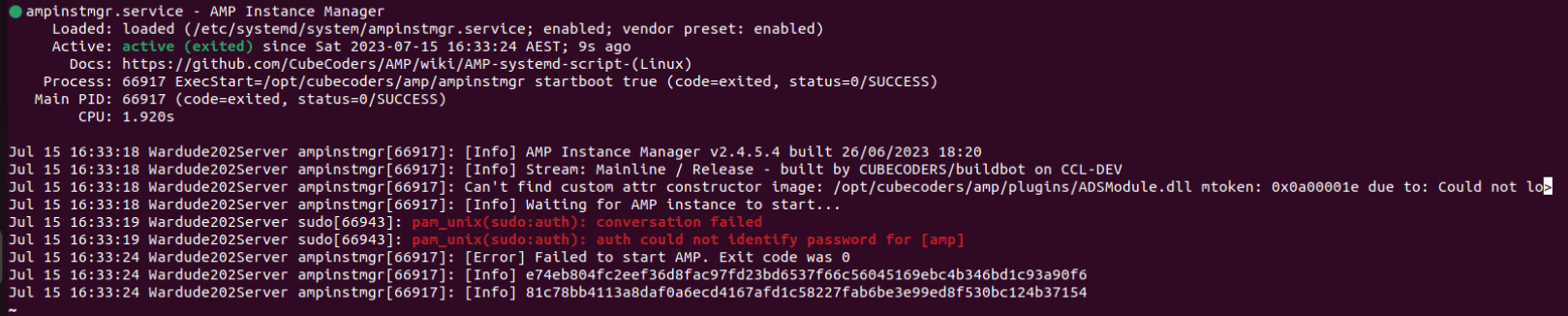

 CubeCoders AMP  💻amp@game  📁~  systemctl status ampinstmgr
● ampinstmgr.service - AMP Instance Manager
     Loaded: loaded (/etc/systemd/system/ampinstmgr.service; enabled; vendor preset: enabled)
     Active: active (exited) since Fri 2023-07-14 23:27:36 UTC; 5min ago
       Docs: https://github.com/CubeCoders/AMP/wiki/AMP-systemd-script-(Linux)
    Process: 1649 ExecStart=/opt/cubecoders/amp/ampinstmgr startboot true (code=exited, status=0/SUCCESS)
   Main PID: 1649 (code=exited, status=0/SUCCESS)
        CPU: 1.932s
Jul 14 23:27:21 game sudo[1675]: pam_unix(sudo:auth): auth could not identify password for [amp]
Jul 14 23:27:26 game ampinstmgr[1649]: [Error] Failed to start AMP. Exit code was 0
Jul 14 23:27:26 game ampinstmgr[1649]: [Info] Waiting for AMP instance to start...
Jul 14 23:27:27 game sudo[1708]: pam_unix(sudo:auth): conversation failed
Jul 14 23:27:27 game sudo[1708]: pam_unix(sudo:auth): auth could not identify password for [amp]
Jul 14 23:27:31 game ampinstmgr[1649]: [Error] Failed to start AMP. Exit code was 0
Jul 14 23:27:31 game ampinstmgr[1649]: [Info] Waiting for AMP instance to start...
Jul 14 23:27:32 game sudo[1740]: pam_unix(sudo:auth): conversation failed
Jul 14 23:27:32 game sudo[1740]: pam_unix(sudo:auth): auth could not identify password for [amp]
Jul 14 23:27:36 game ampinstmgr[1649]: [Error] Failed to start AMP. Exit code was 0
