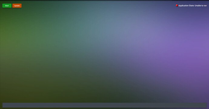

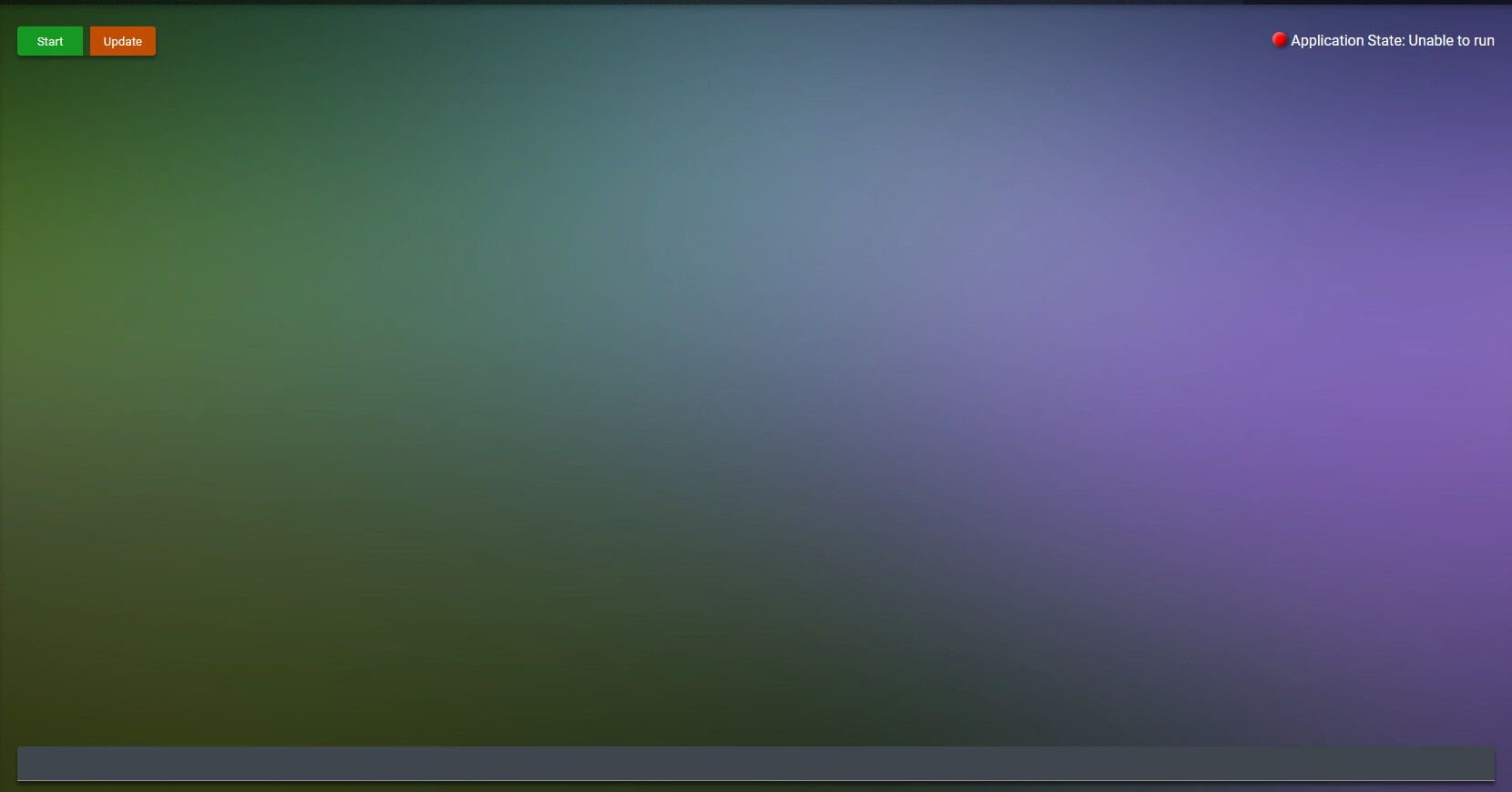

After hitting update, it shuffles for a second.
Then in the console there is nothing that has output:

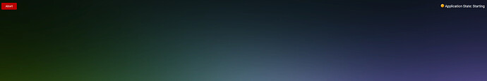

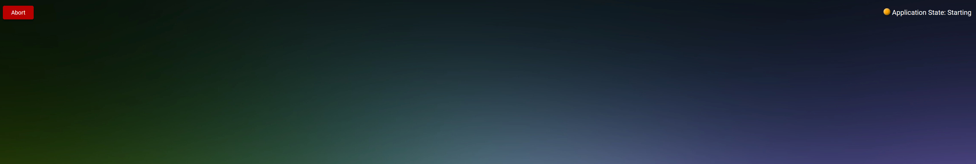

Upon pressing start, it states it is ‘Starting’, but is again not outputting anything to the console.
You will need to fully restart AMP after doing this for it to pick everything up. A reboot may be simpler.
