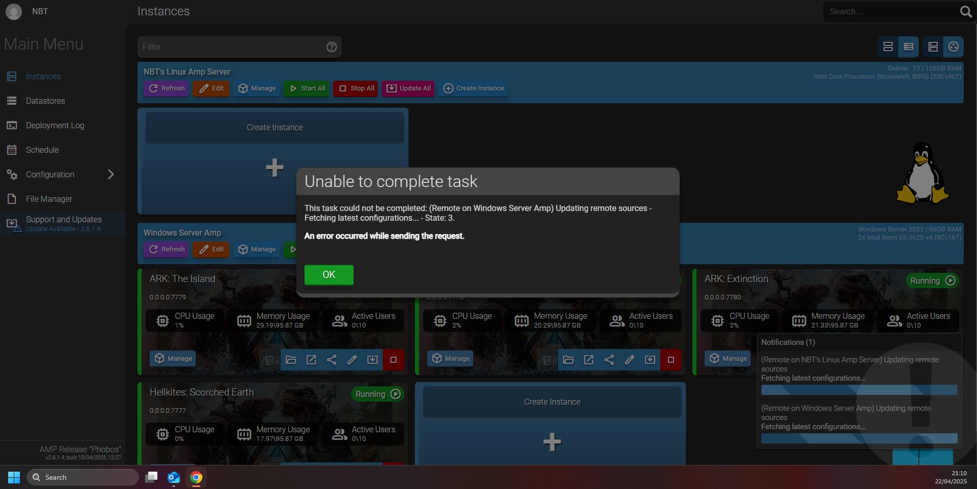

Unable to complete task - fetching lastest configurations
OS Name/Version: Windows server 2022 (Linux Debian server as a controller )
Product Name/Version: 2.6.1.4 - 20250410.2
Problem Description: Error every 2 minutes pooping up

Error message
“unable to complete task - This task coud not be compoleted (Remote on windows server amp) Updating remote sources - fetching lastest configurations… -State 3 / Am error occured while sending the request”
This is the full error i get while just sitting in the main web page / management page or other pages and just waiting .. it seems to come up randomly every few minutes

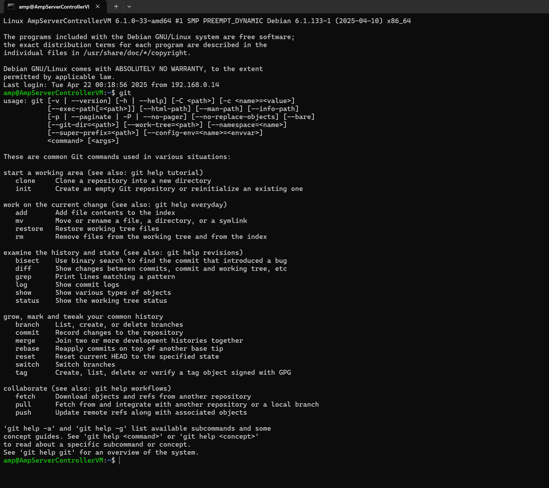

Do you have git installed on the host?
This task could not be completed: (Remote on Windows Server Amp) Updating remote sources - Fetching latest configurations… - State: 3.
An error occurred while sending the request.
Yes i have git installed . I attached an image of the error and what amp shows when the error happens
Edit … Or wait did you mean the windows instance needed also git installed (that did not seem to have it automatically installed but i added it now to see if that resolves the issue if thats what you meant =) )
Edit 2 : ok i tested it after installing git on windows server too and checking it is working .. I am still getting the error
