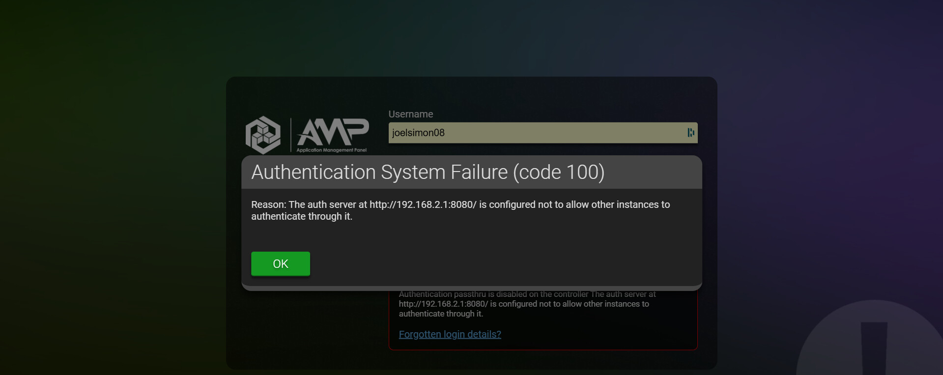

i now tried to connect to the Webinterface of the gameserver by routing
ssh -L 8080:192.168.2.2:8080 joelsimon08@192.168.1.136
and then connected to the webinterface by using
localhost:8080
This means, i’m now connected to the webinterface of the gameserver. It gives me directly following error:
Hopefully this helps

In this post: Controller / Target Configuration Issue · Issue #62 · CubeCoders/AMP · GitHub
It’s mentioned that Security.EnablePassthruAuth=true should be =false on the Target, which it is. I also saw unter the section login Login.UseAuthServer=true
i put it on =false for testing purposes and it seems like the error changed now:
Authentication token for AMP_SYSTEM requested by UpdateRemoteInstancesList on behalf of INTERNAL
Failed to update Server-LN-1 - The remote server rejected the login credentials: Token Rejected
Is it possible that the error “Passtrrough disabled” happens because of “Token rejected” but is getting showed wrong?
