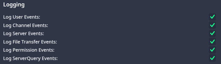

Settings as seen from the TeamSpeak 6 Client → Server settings → Advanced:
  • Create TeamSpeak 6 instance
  • Connect to TeamSpeak
  • Enable event logging
  • Observe user count
  • Created a new TeamSpeak 6 instance
OS Name/Version: Ubuntu 24.04.4 LTS
Product Name/Version: TeamSpeak 6 (v6.0.0-beta8)

I did some digging, TeamSpeak writes these settings to its database.
The relevant table is server_properties, i.e.
SELECT * FROM server_properties
WHERE ident LIKE '%log%'
server_id id ident value
1 1 virtualserver_log_client 1
1 1 virtualserver_log_query 1
1 1 virtualserver_log_channel 1
1 1 virtualserver_log_permissions 1
1 1 virtualserver_log_server 1
1 1 virtualserver_log_filetransfer 1
The setting used for logging user connects/disconnects is virtualserver_log_client
