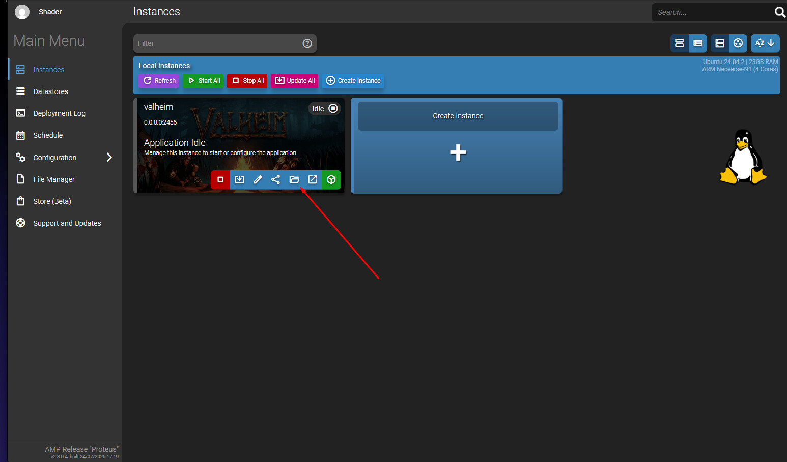

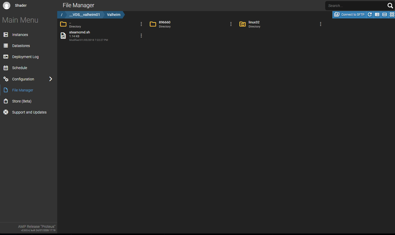

Attempted to use this fix on a fresh instance of valheim. Folder was named llinux32 for the valheim instance, changed to linuxarm64 & then linuxarm32. Both did not work, pressed the update button, everything seemed to download properly, but the file manager was very empty. Should I attach a new log below? If the new update comes out soon I could wait for that.
It should be linux64 you want. Linux32 won’t work.
Just tested this and it worked for me immediately, thank you!

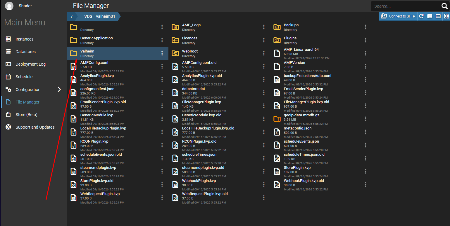

Didnt see any linux64 folder only a linux32 folder. Ill try to recreate the instance to see if it generates correctly
Ahh yeah you’re too far in. You’re doing the File Manager inside the instance. You need to start from ADS and go from there.
ISTG, new instance of valheim and its still shows linux32 what am i doing wrong :sob:
Oh yeah that’s where it should be. What OS/hardware are you running on?
Linux - Ubuntu 24.04.2 on aarch64, running on a oracle cloud compute server
