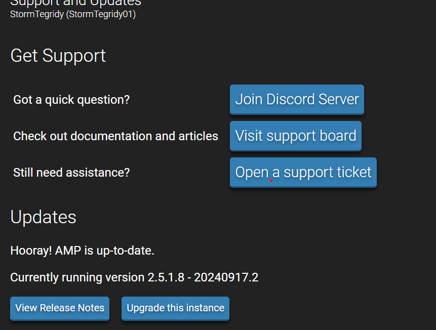

Your templates are months out of date. From the main instances screen (which shows all your instances), update the instance by clicking the down arrow on it. Check the Deployment Log for any errors
According to AMP, it says it’s up to date. Even removing the Instance and starting over it still says the same thing as up above.
AMP and its generic module templates are two different things (don’t get me started). If you did what I asked, I could help you …

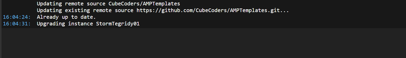

Go to Configuration → Instance Deployment → Instance Management and Fetch Latest under Configuration Repositories. Then check the Deployment Log for any errors, specifically git errors
I realized that after. No need to be degrading. Here is the deployment log after updating the instance.
