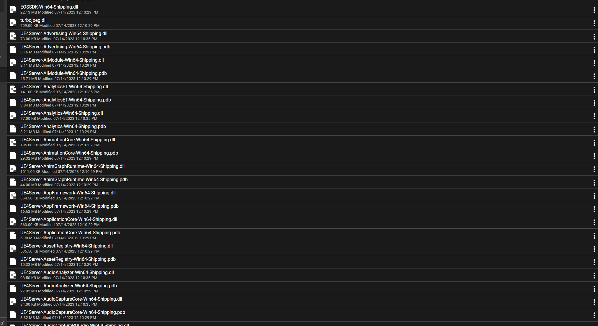

Can you show me the contents of Engine\Binaries\Win64?
Can you show specifically UE4Server-Linux-Shipping
