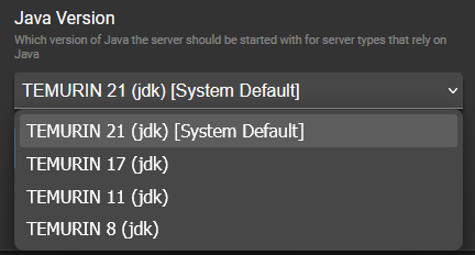

You need to select a newer java version in AMPs configuration.
Are you referring to this? I’ve selected the latest version available.

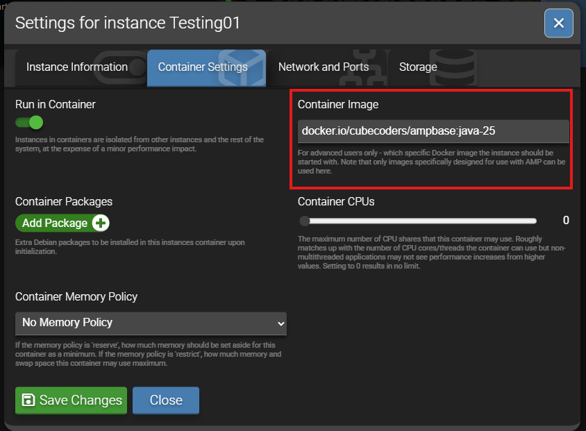

I had the same issue and spent way to long trying to figure it out last night. If you are running the Minecraft server on AMP using docker/ a container you need to select a docker image with java-25 included.
The Java Version in the drop down is if you are running it on the machine instead of in docker.
