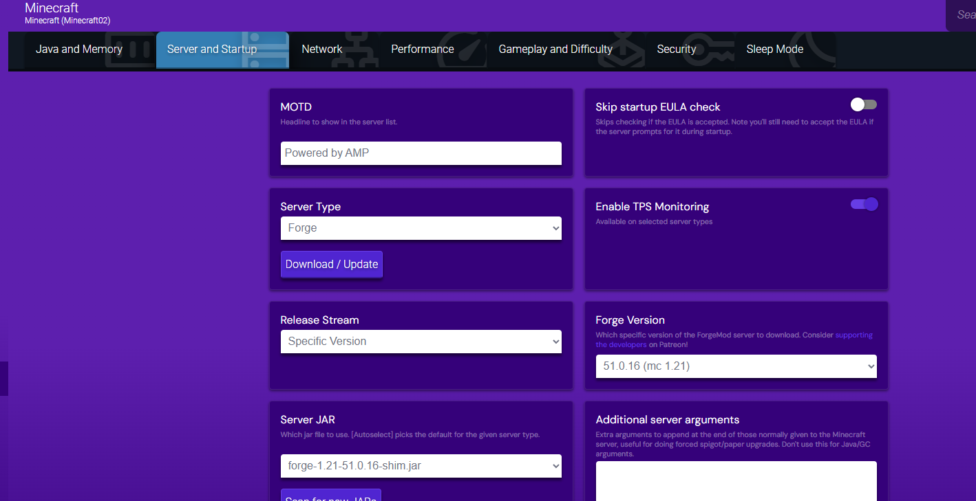

I am trying to change the forge version under the minecraft-server tab. however, when I click on it the website crashes.
  • I click on config. Then minecraft. then forge version. then website crashes.
  • I go to file logs. there it says the minecraft version is wrong.
  • instance stops and wont run

That’s the log from Forge, not AMP. Interested in why the web interface is crashing rather than Forge right now.
when i click forge version it crashes
