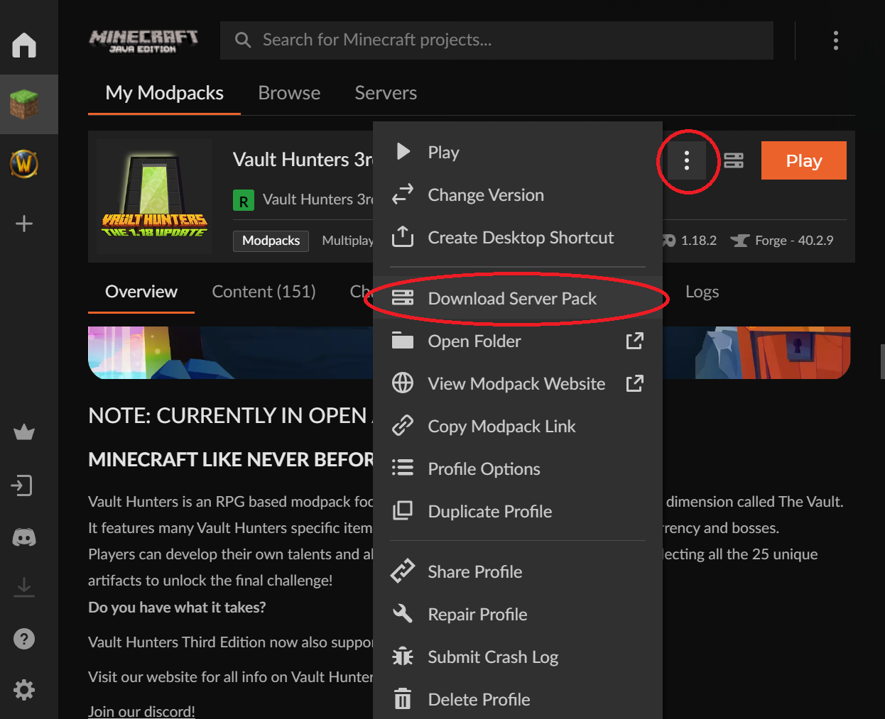

The mod jars from the server modpack on curseforge? Because the client manifest zip wouldn’t have what you need.

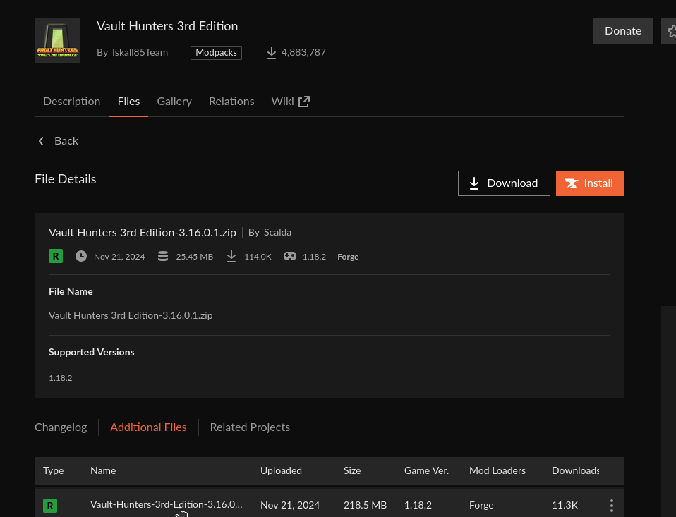

I’m not entirely sure what you’re asking, but I downloaded the modpack from curseforge, I’ll provide a screenshot to show where I got it

If you want to attempt it again, you can find the server pack here:
https://www.curseforge.com/minecraft/modpacks/vault-hunters-1-18-2/files/5925838/additional-files

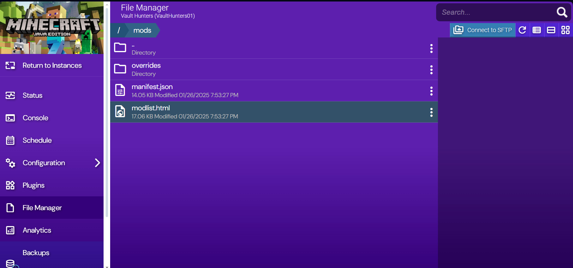

So I tried again with the download you recommended, made sure I was clicked into the mods folder created in the File Management section, and still no dice. It still insists I’m missing mods even thought I hadn’t moved anything in or out of the unzipped folder

I made a folder in this section, and put the vault hunter’s folder in it (zipped, but altogether in one folder) and that was what i was doing originally, then I thought I could take out the few things inside the '“Vault Hunter” folder and put them in the mods folder in case that wasn’t doing it

That doesn’t work yeah, they need to be .jar files, the same jar files from the server pack zip I showed there.
The manifest.json and modlist.html are exclusive to CurseForge, and have nothing to do with a Forge/Fabric/NeoForge server, the server doesn’t know how to read it.

No, you must unzip it and put the jars in the mods folder, because modloaders can only read .jar files, not zips, not jsons, nothing but .jar files
Okay, I downloaded the file (starting over fresh so I know what to focus on). I unzipped it. I put it into the mods folder. It said “no”. So I clicked into the vault hunters folder itself and tried putting in the “mods” specific file (the one containing the .jar files). It said it needed to be zipped. I zipped it, put it into the folder on the server, it still denied me. I took all 148 .jar files from the vault hunters “mods” folder and tried putting them into the server folder, it told me they needed to be zipped.
