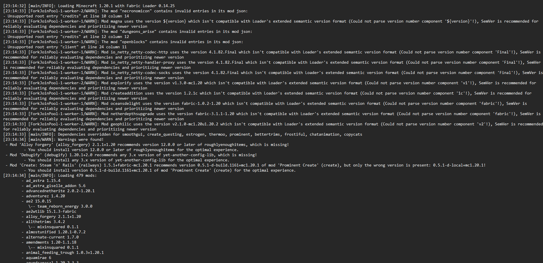

I’ve already done that, the server runs without any mods, as soon as I put the mods and the configuration the server doesn’t start up
You’d need to read the log to see why it doesn’t start.
Probably some client mod that can’t load on the server
I believe ThePotatoKing is 100% correct here. The screenshot you shared showed some warnings, but nothing that is completely game-breaking because it looks like it is still loading. We can’t tell because its not the compete log file and doesn’t show the point of exactly where its crashing at.
I looked up that modpack, and I am assuming your using Prominence II [RPG] v2.8.4 (the latest version), which that version only supplied the client side modpack and not the server files. The difference here is that some mods, like what ThePotatoKing said, only run client-side.
The last version of that modpack that also supplied the server files was v2.8.0hf. I recommend you download that version of the server files, and then try to figure out what was changed between v2.8.0hf and v2.8.4 and manually update/add/remove mods that were changed between those versions… which will be difficult due to lack, or should I say improper documentation of what was done between those versions, i.e. in the change log it said " * Updated some mods", but doesn’t say which ones so you will need to compare over 300 mods to see what was changed.
In short, either download v2.8.0hf and manually add/update/remove the changed mods to bring that server pack upto v2.8.4, or just stick with v2.8.0hf until they update the modpack with the proper server files.
