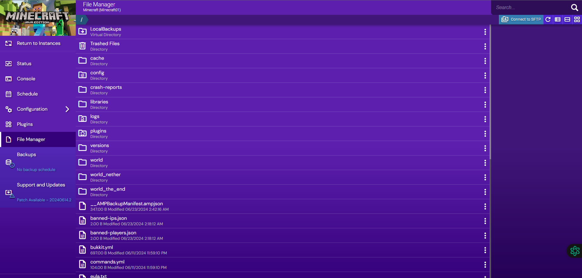

i did that but i dont know where i have to put the .jar
In the main server folder
Here?
That’s what I said, yes.

Worked , thank you
I had tried a lot of things but only this one worked
