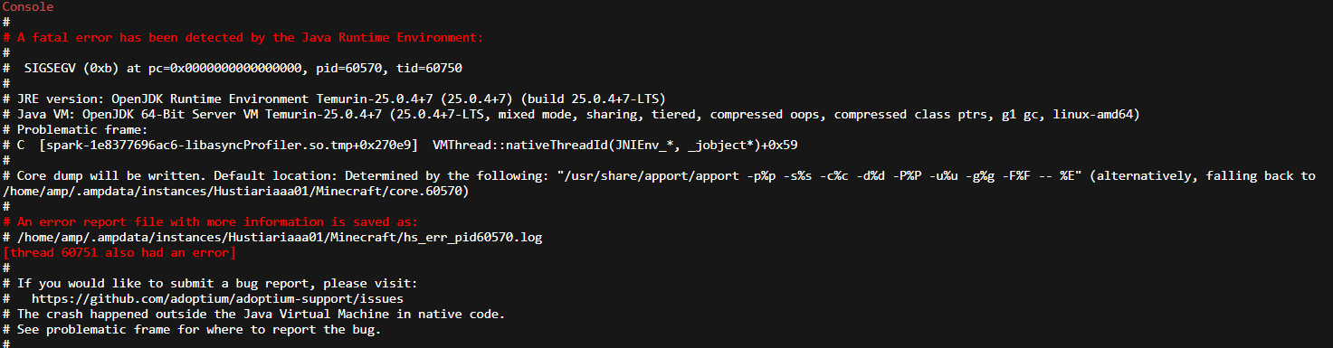

Look in the console when you hit start and see what feedback/error it is giving you.
all i get is “the minecraft server repeatedly failed to start, this is no a faul with AMP - you should check your minecraft servers log files to find out why it is unable to start” and this massage as a last thing
Make sure you are running the latest version of java under the update settings. Not sure what else to recommend though here.
