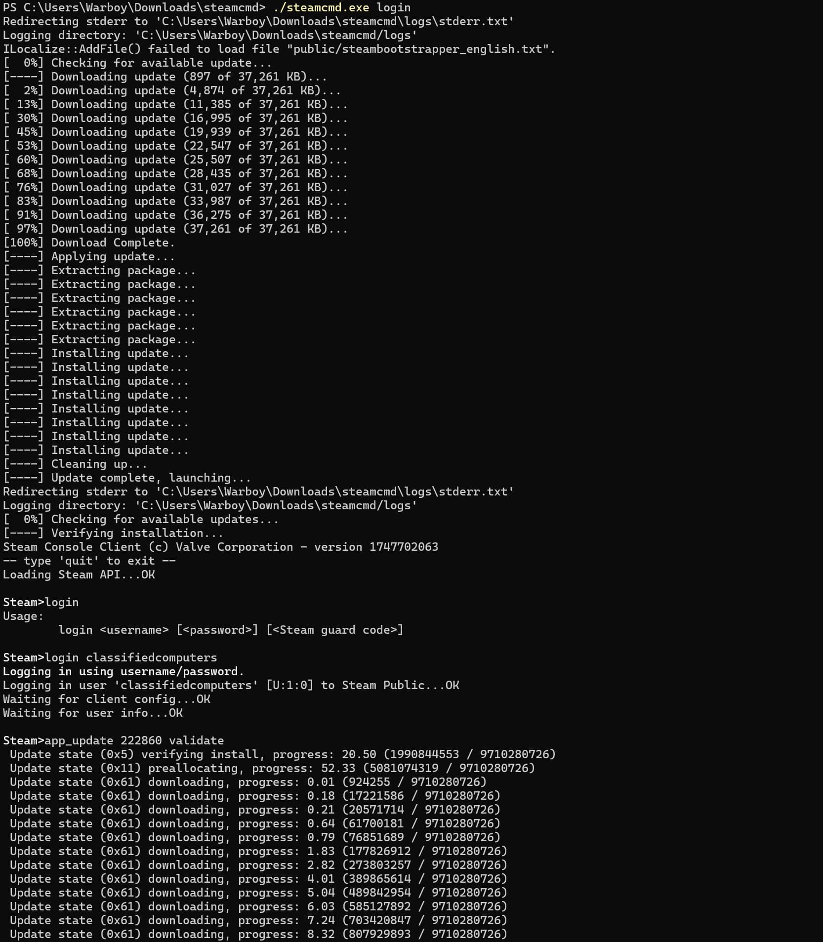

Here is steamcmd on windows vs AMP.
Again, it’s not my account and I linked the github because it accurately shows the problem as well for other people attempting to use the linux steamcmd.
On the Windows variant as well, anonymous login also allows the appid to download.

IPC function call IClientAppManager::GetUpdateInfo took too long: 79 msec
 Update state (0x61) downloading, progress: 51.44 (5036830872 / 9792563589)
 Update state (0x61) downloading, progress: 51.46 (5039270400 / 9792563589)
 Update state (0x61) downloading, progress: 51.48 (5041372473 / 9792563589)
 Update state (0x61) downloading, progress: 52.24 (5115439413 / 9792563589)
 Update state (0x61) downloading, progress: 52.26 (5117463472 / 9792563589)
 Update state (0x61) downloading, progress: 55.51 (5435698662 / 9792563589)
 Update state (0x61) downloading, progress: 56.30 (5513562395 / 9792563589)
 Update state (0x61) downloading, progress: 60.94 (5967450624 / 9792563589)
IPC function call IClientAppManager::GetUpdateInfo took too long: 85 msec
IPC function call IClientAppManager::GetUpdateInfo took too long: 51 msec
 Update state (0x61) downloading, progress: 64.00 (6267460824 / 9792563589)
IPC function call IClientAppManager::GetUpdateInfo took too long: 41 msec
 Update state (0x61) downloading, progress: 68.67 (6724372812 / 9792563589)
 Update state (0x61) downloading, progress: 70.65 (6918632205 / 9792563589)
 Update state (0x61) downloading, progress: 75.42 (7385550936 / 9792563589)
 Update state (0x61) downloading, progress: 78.19 (7656926673 / 9792563589)
IPC function call IClientAppManager::GetUpdateInfo took too long: 65 msec
 Update state (0x61) downloading, progress: 82.05 (8035019168 / 9792563589)
 Update state (0x61) downloading, progress: 84.22 (8246962604 / 9792563589)
 Update state (0x61) downloading, progress: 86.06 (8427768252 / 9792563589)
IPC function call IClientAppManager::GetUpdateInfo took too long: 44 msec
IPC function call IClientAppManager::GetUpdateInfo took too long: 49 msec
 Update state (0x61) downloading, progress: 88.57 (8673390101 / 9792563589)
IPC function call IClientAppManager::GetUpdateInfo took too long: 99 msec
 Update state (0x61) downloading, progress: 91.96 (9005227468 / 9792563589)
 Update state (0x61) downloading, progress: 95.72 (9373449844 / 9792563589)
 Update state (0x61) downloading, progress: 96.83 (9482478201 / 9792563589)
IPC function call IClientAppManager::GetUpdateInfo took too long: 50 msec
 Update state (0x61) downloading, progress: 97.43 (9540442662 / 9792563589)
 Update state (0x61) downloading, progress: 97.45 (9542445229 / 9792563589)
 Update state (0x61) downloading, progress: 97.49 (9546398637 / 9792563589)
 Update state (0x61) downloading, progress: 98.36 (9632434855 / 9792563589)
 Update state (0x61) downloading, progress: 99.24 (9717799470 / 9792563589)
 Update state (0x61) downloading, progress: 99.99 (9791515013 / 9792563589)
 Update state (0x81) verifying update, progress: 8.15 (797721218 / 9792563589)
 Update state (0x81) verifying update, progress: 17.58 (1721379997 / 9792563589)
 Update state (0x101) committing, progress: 51.92 (5084753778 / 9792563589)
 Update state (0x101) committing, progress: 52.00 (5092519341 / 9792563589)
 Update state (0x101) committing, progress: 64.55 (6321262075 / 9792563589)
 Update state (0x101) committing, progress: 81.09 (7941239565 / 9792563589)
 Update state (0x101) committing, progress: 97.44 (9541675418 / 9792563589)
IPC function call IClientAppManager::GetUpdateInfo took too long: 60 msec
Success! App '222860' fully installed.
quit
