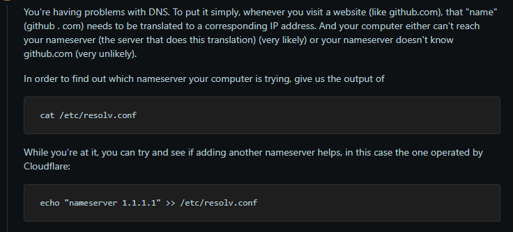

Every time I try to start the the server it tries to update but fails with this message below.
"This task could not be completed: Running Update Tasks - - State: 3.
Error performing update stage BeamMP Download: Resource temporarily unavailable (api.github.com:443)"

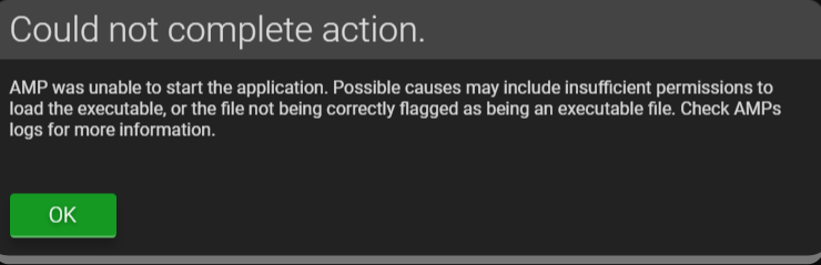

Fixed Other issue above now its saying this.
“AMP was unable to start the application. Possible causes may include insufficient permissions to load the executable, or the file not being correctly flagged as being an executable file. Check AMPs logs for more information.”
I checked logs and it doesn’t tell me anything other then I attempted to Start the server.

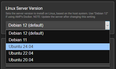

Did you select the right version to download for your distro?

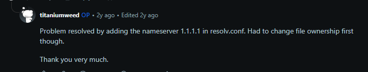

I ended up getting it working now. Was trying to not use the Docker as I didnt know how it worked but then I tried it and it worked fine with the Docker. The Github issue was what I have in attached images.
There’s a version selector where you could have selected the right build for 24.04
Is this what your talking about? Just change this to 24.04? New to all this and learning.
Also still getting this error no matter what I do now.
Well, did you do what the dialog box says?
