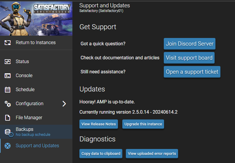

Update your instance from the main instances page to refresh the template. This should have been addressed with some recent changes.
Thank you Greelan, looks like it was indeed fixed in 2.5.0.14 - 20240614.2
The template is actually independent of the AMP version, but glad it sorted it for you
Where do you see the template version so I can make better tickets in the future?
It doesn’t appear in the UI. There is a config version that is in one of the files for each template but that hasn’t been consistently or meaningfully used in the past
