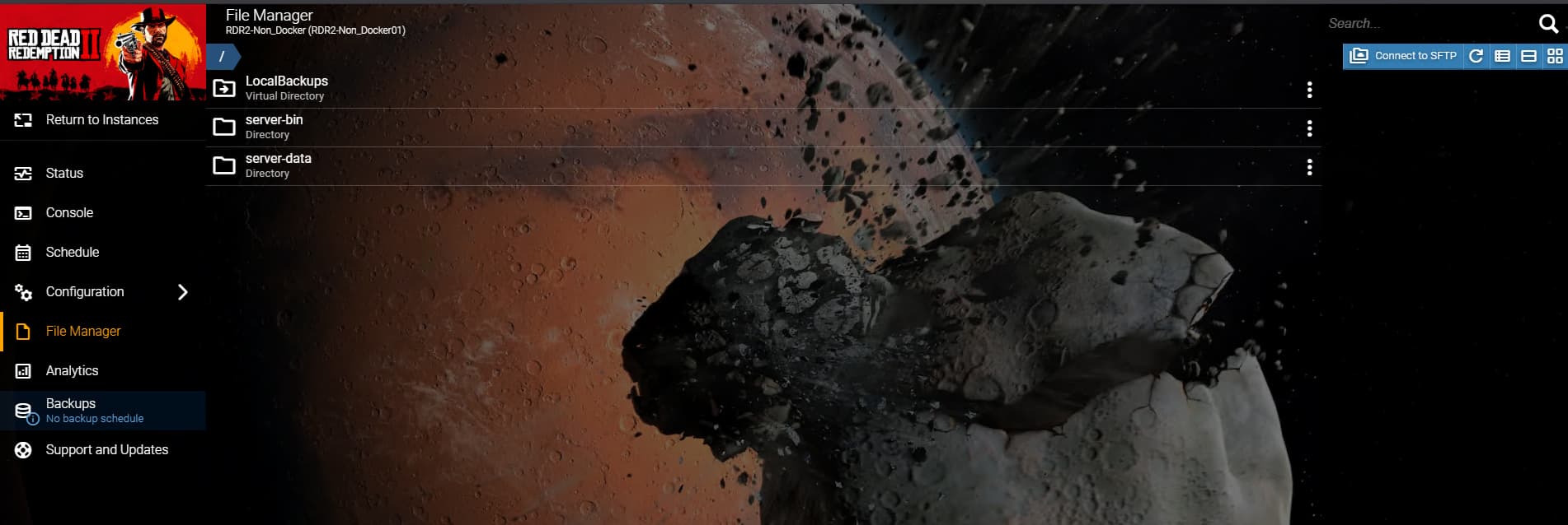

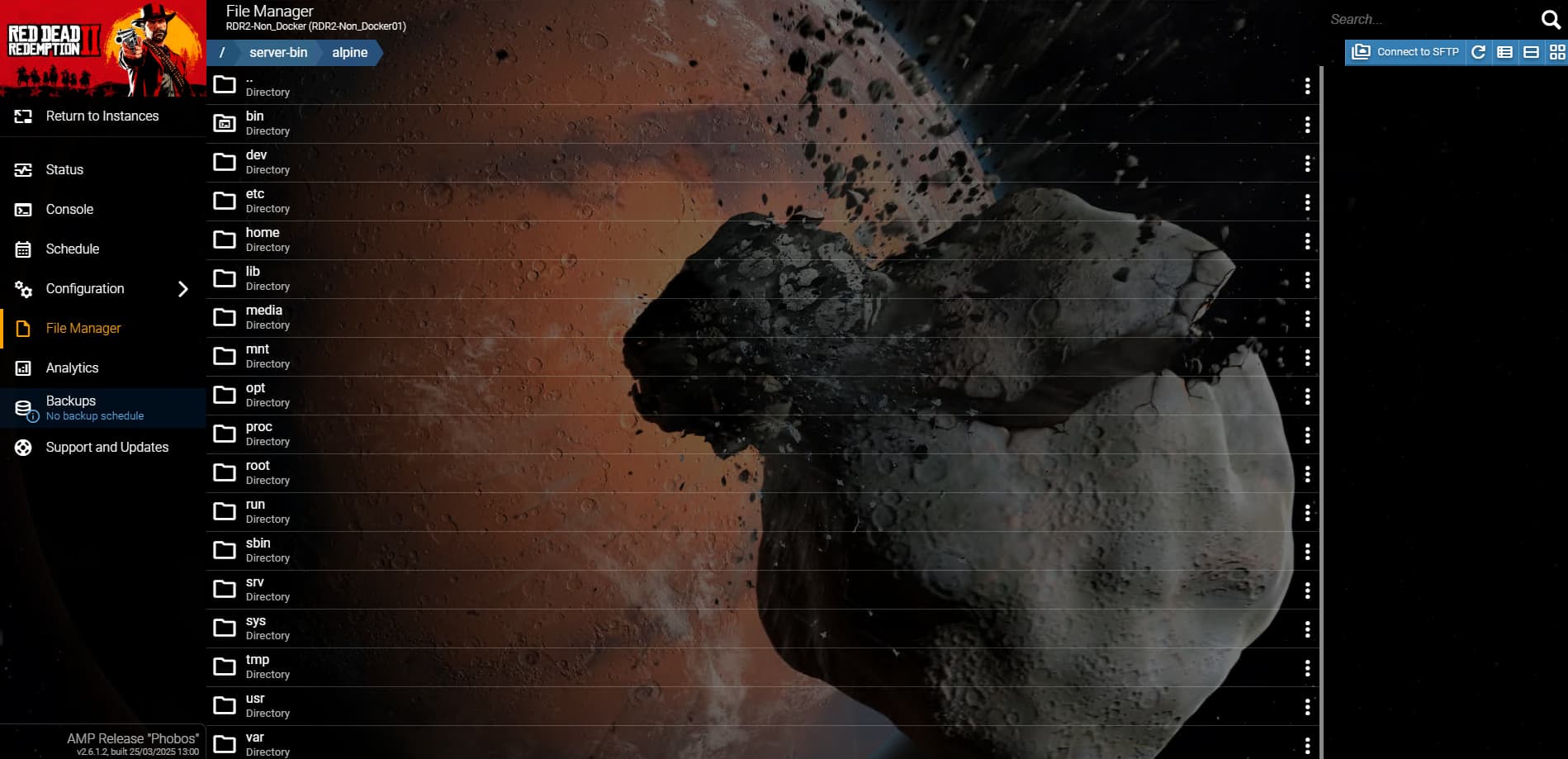

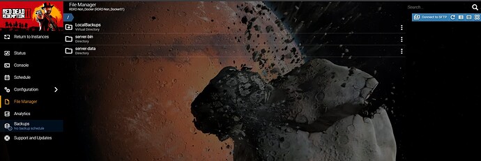

@Dezrin Can you share a screenshot of what you see when you click the File Manage from inside the instance?
Of course, image below
Is there anything inside those folders?
Yes, there is
