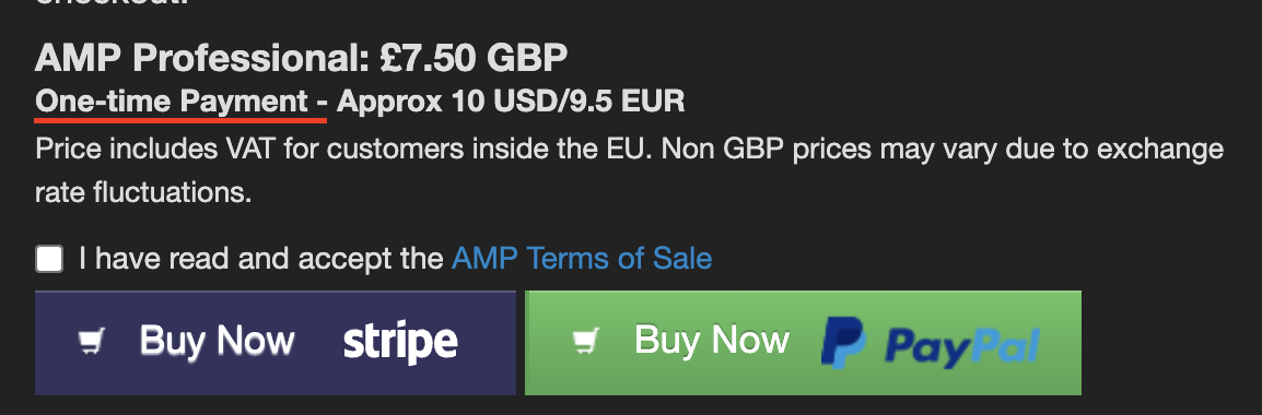

  1. I see no mention of a subscription. Would I be correct in assuming that the licenses are permanent?

  1. AMP can be installed without a licence to check that you can get it running and that it works on your system, but creating the actual game servers requires a licence.
