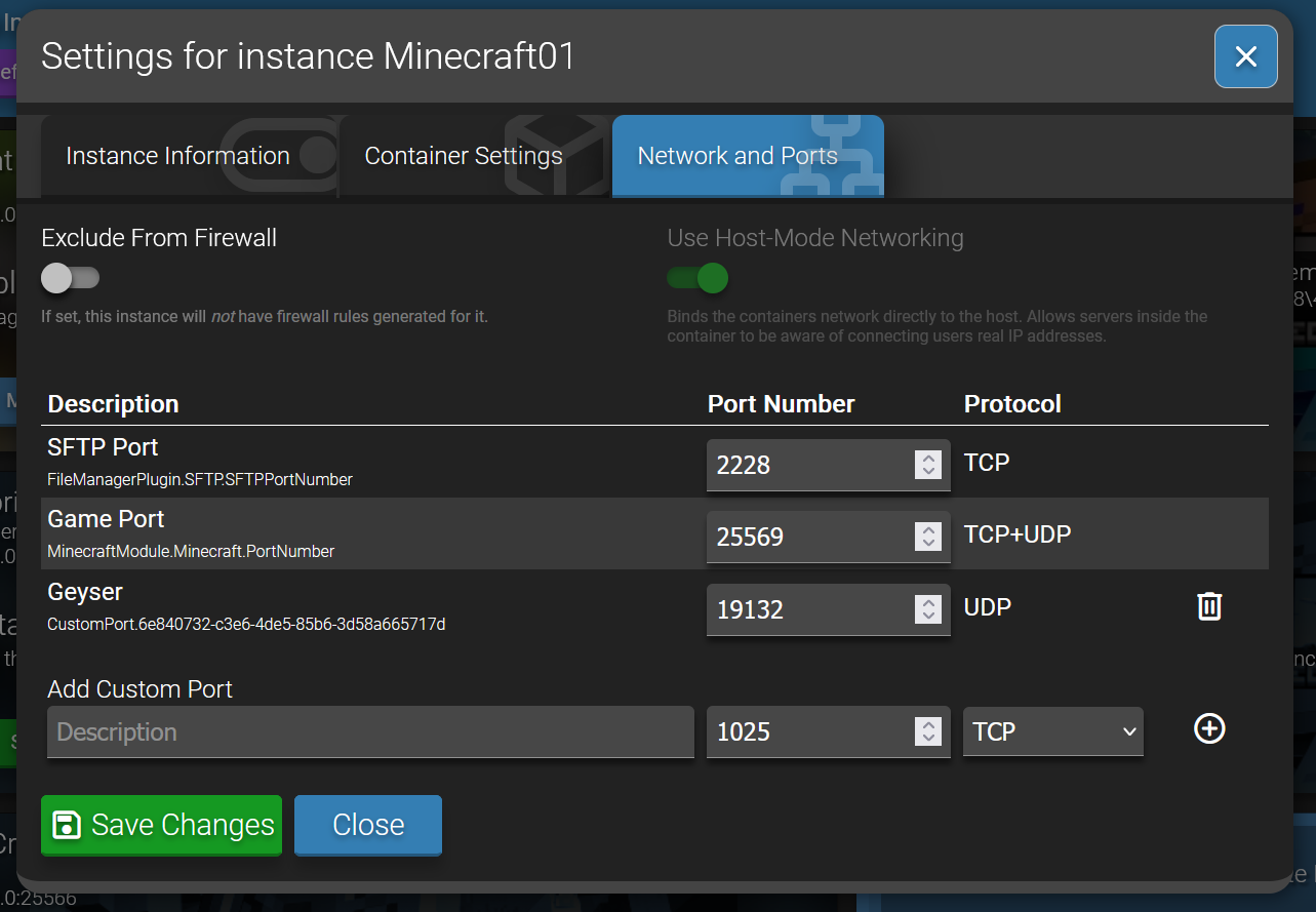

Show your port settings in AMP for that instance?
Yeah, and here in lies the problem.
Yeah, there is a major bug atm
Good to know, thank you! However, is there any way to open them manually in the meantime?
