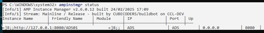

Tried as suggested ampinstmgr startall - seems fine, no error messages and then shows this when i check ampinstmgr -status
(left arrow) ]8;;http://127.0.0.1:8080/ADS01 (left arrow) ]8;; ADS ADS 0.0.0.0 8080

Reinstalling won’t help - run ampinstmgr lastlog ADS01 and see if something is preventing it from starting.
Also I’d recommend downloading the newer Windows Console.
