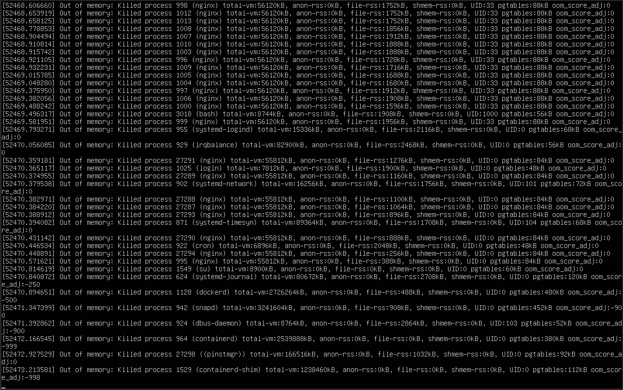

edit: let it run overnight and it did it again, here’s a screenshot of the terminal
And I just created a new, blank Minecraft server and it immediately crashed
