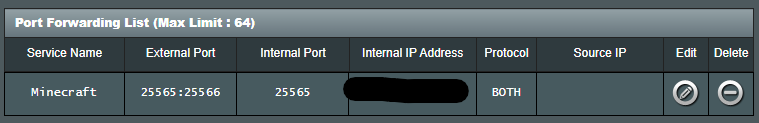

I assume I put my primary endpoint minus the port on Internal IP Address?
If the port is anything other than 25565 you put your public IP plus the game port, eg:
1.2.3.4:25566
And if it’s anything other than 25565 you must port forward the new game port as well

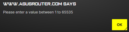

I tried putting my public IP Address in the external port. Guess that wasn’t the right answer.
I meant to use your public IP when using that MC status checker website.
Generally your internal and external ports should be the same, and when testing to see if the port forward works you use some external test using your public IP and the external port.
Sorry about that. I put my public IP:Port onto the website and nothing showed up.
Double check to see if the WAN IP in your router matches the Public IP you got from googling “What is my IP”.
