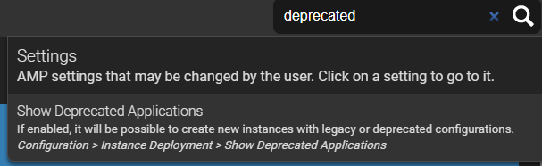

Settings Changes
Within AMP, find the “Show Deprecated Applications” option and enable it:

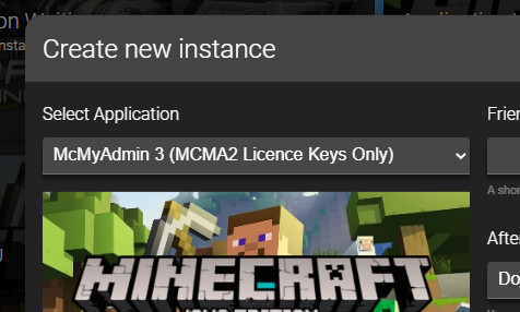

After enabling this setting, a “McMyAdmin 3” option will show up when you create an instance:
This instance type accepts older McMyAdmin 2 licence keys for managing Minecraft servers.
