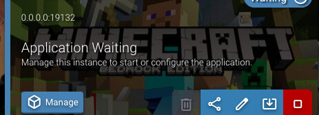

I had no issues with the archiving/copying/unarchiving the .ampdata folder and the instances do appear in the new console. However, none of the instances will actually start up. They remain in “Application waiting” state, like this:
